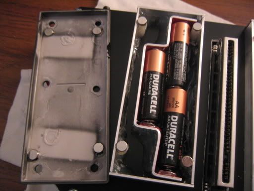

Update! Time for some delicious new pictures!
Before adding battery compartments...
Testing to see if it's still working :wink:
The new battery compartments! Yes, it's the back of the NES controllers. I'm like an Indian of the Great Plains - I use every part of the buffalo :P

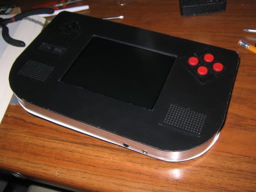

A pic with the screen in. The back actually lines up better than it looks like in this picture. I don't think the back's even screwed in place here... When I'm done I'll sand all the edges flush with the aluminum sides.

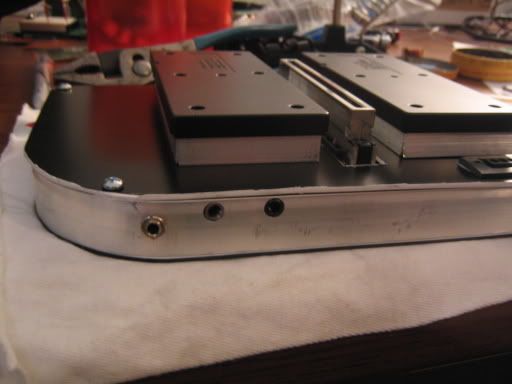

From left to right, it's the power, headphone, and A/V jacks.

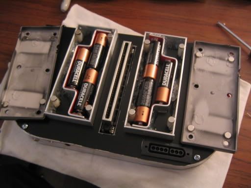

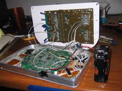

A look under the hood. Isn't hot glue great? I used epoxy to hold in the Rare Earth magnets - they hold on really really tight. Notice the player 2 port... couldn't fit THAT into Ben's SNES design, now could we?

Ah, one last thing - I LED modded the screen with four 10,000 mcd LEDs and I used the brightness mod. The only problem I'm facing now is screen distortion with bass from the audio. It's driving me nuts and I don't understand how to copy what segasonicfan did in isolating the grounds of the audio circuit. Any help would be appreciated.
