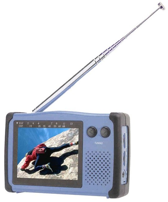

Also, check the tv below. I've used it for this portable. It's the best screen I've ever seen. It works with 4 x AA batteries, has a great resolution, has high-quality components and it even accepts RGB.
http://cdn.overstock.com/images/product ... 183075.jpg
