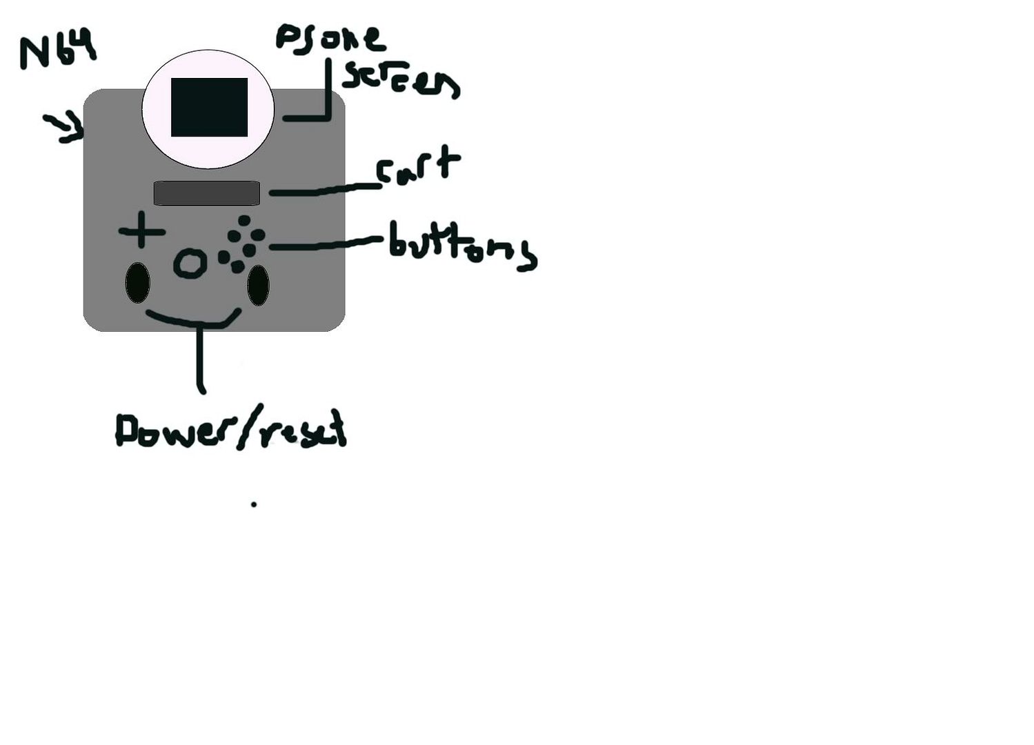

ok here is one of two layouts im gonna try, the second one is where the screen and buttons are mounted to the botto of a regular n64 and the cart is sticking out the back along wiht the reset and power swiches
I'm a begginer @ hacking, be patience

If you are going to post pictures, either crop them to a reasonable size that won't stretch the screen, or link to it.
Your A, B, and C, buttons, as well as the joystick are way too close to the center. If you could somehow fit the controller board above the mobo and memory/jumper pak in the center, you'd still be reaching too far. Unless you cover the power and reset switches, you will accedently hit them all the time, which means you better save often. If you want to go with that design, you'll also have to mount the screen on the back(like how it attaches to a PSone), because you have a lot less room on an N64 than what you drew.

put the cart slot somewhere else and put the buttons closer to the sides and put the power/reset switches out of the way and it'll be good :D . N64s not a bad thing to start with; i'm started with one and it's not too hard
