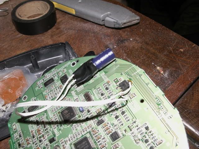

I'm happy to say, that The PlayMad is DONE!

Only changes since last update was I had to do an LED mod since the normal screen backlight kept dieing.
A capacitor was added to the 5V out line on the regulator to help clean the picture up too.
And other than that, it was just some rewiring on the d-pad controll board since some leads slipped together.
With connections that tiny, and all the moving around, stuff can slip.
The only hard part of doing that, was getting the board out of the hot glue. I ended up heating a knife blade with a lighter, then cutting around the hotglue, that way I didn't have to build up all the hotglue again.
