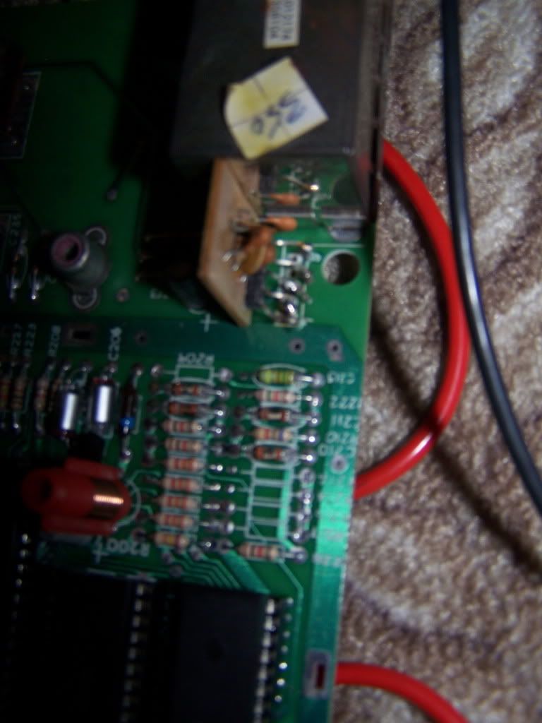

http://benheck.com/book/support/Atari2600VidMod.htm" onclick="window.open(this.href);return false; heres the website. I made it but ive been having issues mainly with only having a scrolling black and white picture. Anyone ever done this mod?

negative im hooking it to a tv. i also would like to know if i should remove rf stuff becase i already removed them.
Re: 2n4401 mod
I've done this mod and it works great. I don't know what your problem should be. Check your wiring and soldering...

This is what ive got, is the transistor backwards in the diagram?
Re: 2n4401 mod
Yeah, you should remove it.
