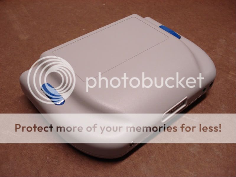

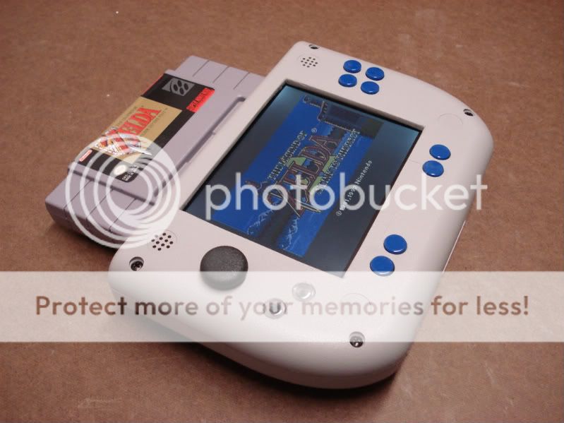

Presenting the Nintendo SuperBoy, my entry for the competition. This SNESp was made using a Retro Duo, an AG-85 project enclosure box from polycase.com, an LED modded PSOne LCD screen and two internal 3.7v 3200 mAh li-poly batteries.
This portable features a couple of ideas from other forum members that were just begging to be put together - a comfortable compact case with controls that fit. The joystick is simply a PSOne controller's joystick epoxied on top of a multi-directional tact switch. It is digital, meaning it only registers the normal 4 directions used by a Super Nintendo. Not only is it comfortable to use (no sore thumbs for me!), this thing was made to play StarFox which is one of my all time favorite games.
The durability of this case and the relative ease to make it are some of this portable's strongest points. No paint, bondo, or spot filler was used in the construction of the case which means there is nothing to wear down. The cartridge slot is also very snug, as demonstrated in my video by smacking it and not getting a single glitch!
This portable also features the usual AV out, headphone, charging, and player 2 jacks. However, I managed to make them all absolutely flush with the case to keep with the overall smooth appearance of the portable.
Start Date: July 21, 2008
End Date: August 22, 2008
Eligible
