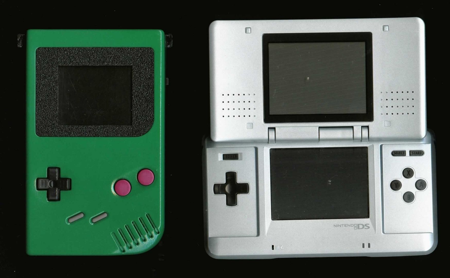

If you haven't seen my first NESp in a GameBoy case here it is. Anyways it was stolen on a skiing trip so I went ahead and made a replacement. And I came up with an even cheesier name than before, NES Boy. :D
Here is a scan of the front, with a DS next to it for size comparison.
(clickable thumbnails)
Yes, it's actually GREEN! How about that. Not many green NES portables out there. ;)

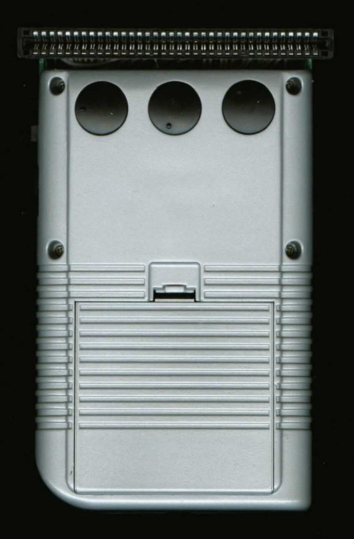

And the back. Silver. DS silver. Sexy silver.

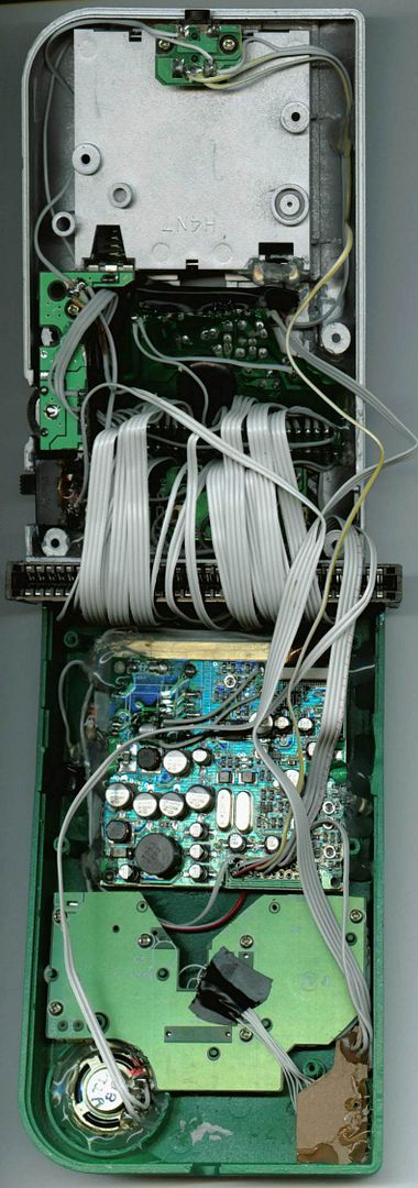

Check out the guts. :shock: It took some tricky finger work to get it all together.

dang i actually read it and i am just amazed. the guts; they are so packed in. any chance of a small guide coming eventually on how it was all crammed in?
