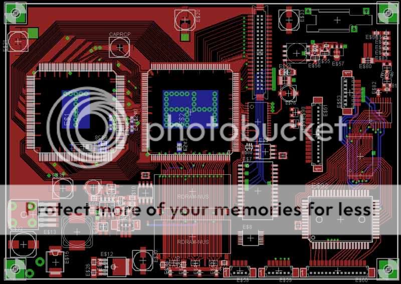

Well, figured you guy's would like an update on the board, FINALLY finished all the connections between the CPU and RCP. I've checked them as I went along but, I'm gonna give them a really good look over once more and verify against the official board. I was able to fit in plenty of grounds between signal traces so it should be ok. I was able to squeeze things in just a bit more so I managed to shave off a few mm from the horizontal length of the board. here 'tis:
kibble
Posts: 439
Re: Do we have room for another N64P? (t64 WIP)
Post by kibble »
Mario wrote:This is amazing! It's very obvious you've put tons of work into this already. I really want to see this completed. :D
Just one aesthetic note, though. The T64 vias are hidden under the chips! :wink: Move the T to the other side and flip the 64, like this:
So that when you flip the board over and look at the bottom, T64 is the right way around! :mrgreen:
I don't know how I missed this post but, you make a valid point! I was originally intending to see it from the top, but I guess I completely forgot that the T and 64 were going to eventually be covered by the chips. :mrgreen:
dragonhead
Posts: 952
Location: NH, USA
Post by dragonhead »
great looking design. bit it looks like you may be able to squeeze a little more size out of it. if you rotate the 6 pin header at the bottom 90° (E$35 i believe) you may be able to shorten the board's width some more. i think theres a program that allows you to feed in a schematic and it calculates the smallest and most compact layout it can achieve with that schematic. not sure though
i also think i know how you can squeeze a little more out of the height of the board... id like to discuss it with you if you want.
EDIT: you mind if i snag the eagle file from you? i could play around with it to try to make the layout more efficient/smaller if you want. i also thought, for the LCD, could you tap into the digital RGB signals being fed into the AVDC-NUS? just curious...
Skyone
Posts: 6390
Location: it is a mystery
Post by Skyone »
dragonhead wrote:i also thought, for the LCD, could you tap into the digital RGB signals being fed into the AVDC-NUS? just curious...
That's what I mentioned up a few posts. Definitely the most efficient way to do video.
@kibble: Looking nice! I'm wondering how long it's going to take you to route/desolder/solder all of the decoupling capacitors on the underside of the PCB though :?.
