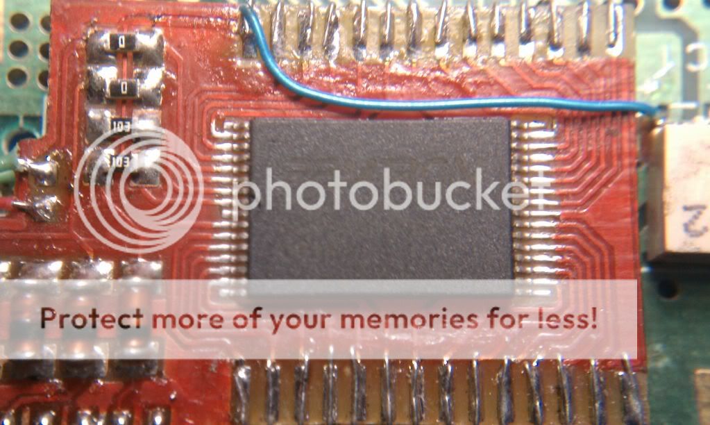

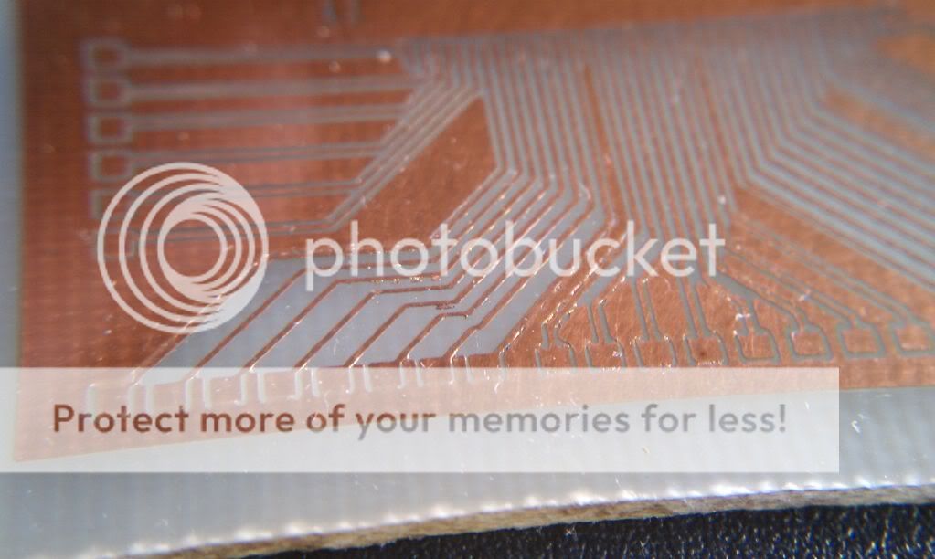

Well, if the transparency isn't totally messed up, I can get really good results like in the first pic, and sometimes I get bridges and holes like in the second one.

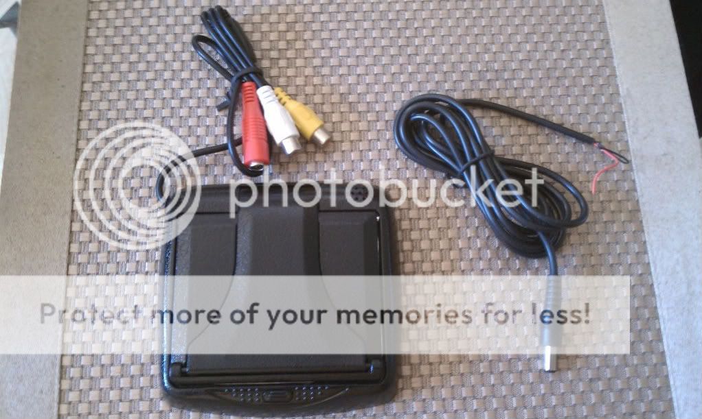

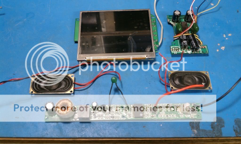

But I do have something to reveal. for a bit over a month now I've been working on another project in parallel to this one and in fact, some of the tech that's being put into this project is making it's way into the other one, partly because it allows me to do testing as I go. What is it you ask? It's another N64 Portable, but one that won't contain the t64 board or digital video. I'm dubbing it "project xylem" for now and I will name it later. You'll find out why. The goal of this other portable is to help me with figuring out some things and quickly make a portable in the process that will be for sale when completed to help fundage with the other one. I'm not going with "smallest ever" or anything with this, but if it all goes well, it will be quite unique looking.
Currently, the specs are as follows:
3.5" composite input screen (eBay)
2.5W Stereo amp
Heavily trimmed n64 board (to be done)
Ability to charge and play at same time
Battery TBD
FRAM game save memory
8MB memory
Thinking about:
Dock with 4 controller ports and A/V outputs.
Some of the parts I'm using:
2.5W Stereo amp
Battery TBD
8MB memory
Thinking about:

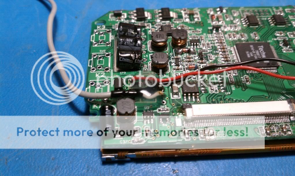

I had to to a bit of work to the LCD that I received. I was going with something along the lines of the first flip up screen on Hailrazer's 3.5" LCD guide. Fortunately, after a bit of soldering sorcery, I got it looking pretty good and nice and compact! Check it out:
Long ribbon cable....
And the LCD can't connect directly to the bottom board because its connector is on the side and it's smaller... .
Oh, but what's this? There's solder pads for that exact same size connector on the main board!
Le remove connector from adapter board, le solder onto main board.
Relocate a few caps that are present on the big connector to the smaller connector.
Plug in LCD and BAM....wait awwwwww.......
Remove and reinsert FPC... WOOT!!!
Place sheet of plastic between LCD and main board and double sided tape both together.
Dab of hot glue on wires.
Voila!
