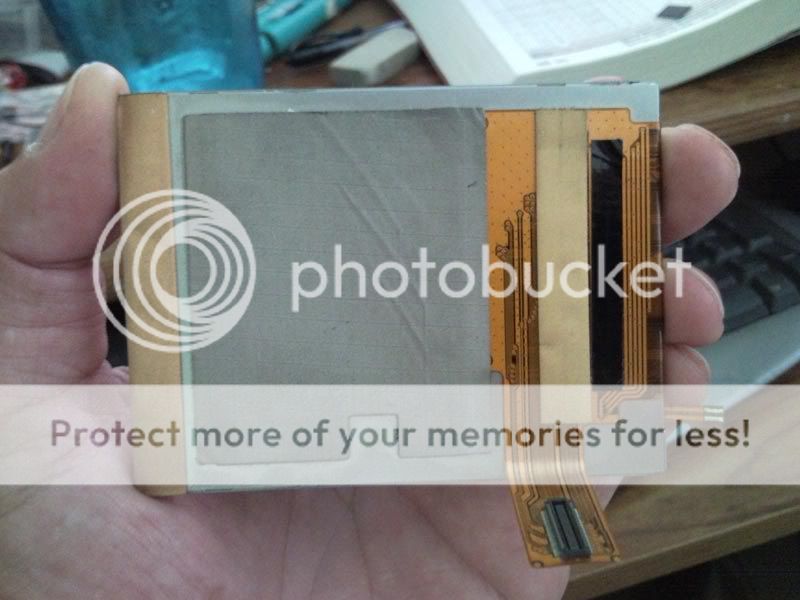

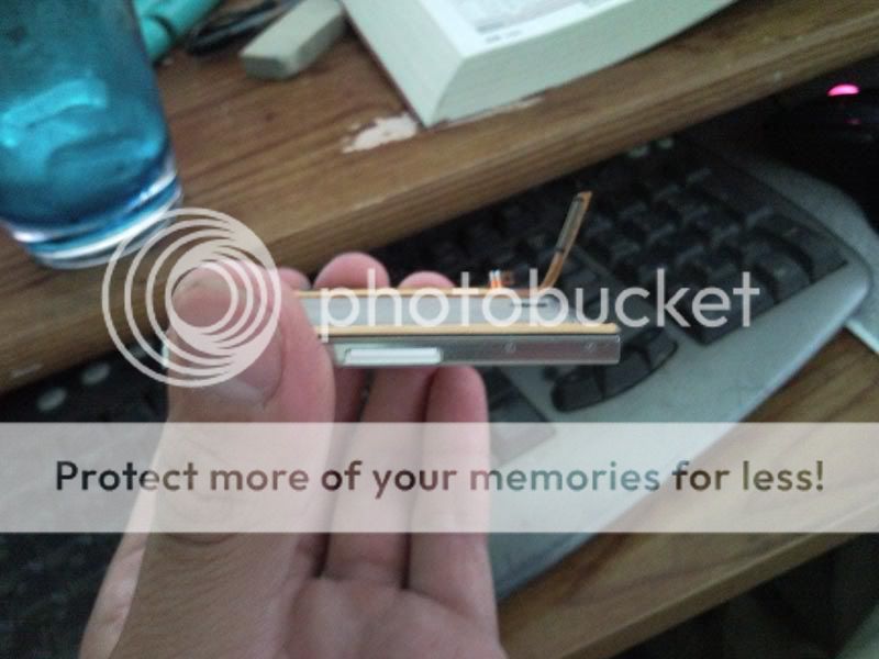

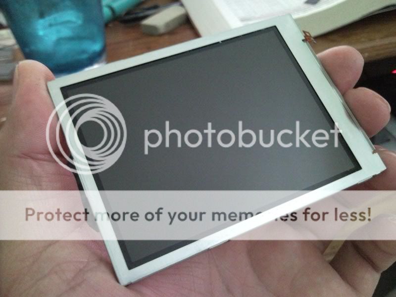

I completely forgot I had these LCD's, 3.5" TFT with LED backlight and less than 1/4" thick. Unfortunately they take 18bit RGB data and I have no controllers for them. I got them from two of my PDA phones that I broke the touchscreen on. If I could find or make a controller small enough to fit on the back of them that accepted video input, that would be awesome. I have been searching for a video to 18bit RGB chip but have found nothing so far. Interfacing it directly to the RCP chip would be even better, but that puts out 21bits of color data plus the sync signals all together.... ideas, ideas..... LOL

kibble, what about pulling RGB-analog straight from the n64 and running it into an ADC to get the digital signal you need?

dragonhead wrote:kibble, what about pulling RGB-analog straight from the n64 and running it into an ADC to get the digital signal you need?
That's one idea, then I'd just have to figure out a way to generate the clock signals for it.
64M320N3 wrote:Doesn't that screen use digital RGB?
I have something like it, but analogue signals don't work on mine. If yours is different or you can make a decoder board you will have to tell me what parts you used.
Correct me if I am wrong, but wouldn't be cheaper to buy, say, a 3.5" monitor off dealextreme.com than build a decoder board for that thing?
Yes, it uses 6 bits for each of the colors. It probably would be cheaper/quicker to use parts already made, of course but, messing with this stuff would be a learning experience. One IC that I do know is necessary for this LCD is a Samsung LCC3600A right before the inputs. Oh and btw, this screen is a Samsung LTS350Q1-PE1 that came out of a Samsung SCH-I700. I'm most likely not going to be including this display on this project for now. Maybe later on I'll make it a project in itself to figure out how to use that screen and then maybe I'll make another portable. :lol:
