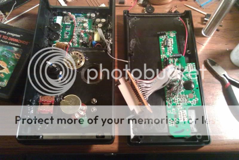

Sorry for the lower than usual image quality but it's just so much easier to snap a pic with my Droid Eris phone and have it upload directly to my Photobucket account. I made some good progress tonight. Time to catch some sleep before a long day tomorrow of tests and work.
...of course now that I look at the pictures on my computer's screen they don't look all that bad so never mind.

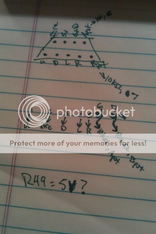

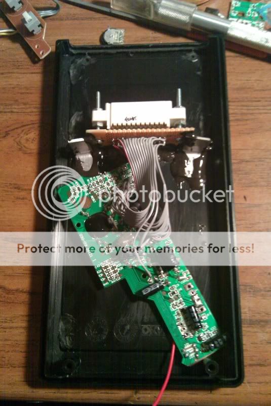

Oops. I kinda chopped off a bit too much. This is the player one controller jack... chopped off. I mapped where everything goes so it is no big deal, but still...
At least the board fits where I wanted it to go, which was the whole point of trimming the board.

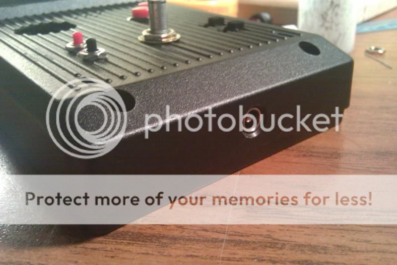

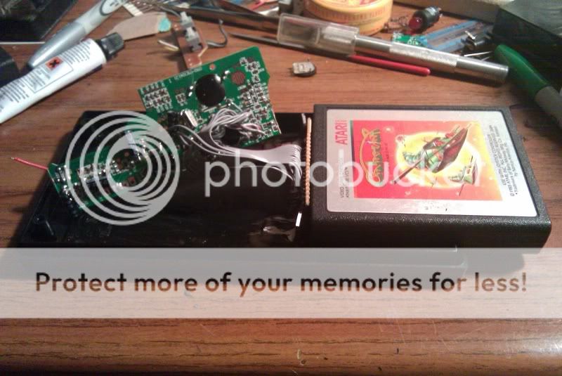

Mounted the cartridge connector today. It's not pretty, but thanks to JB Weld it is rock solid. Plus it will be one of those things that are on the inside that you will never see once the portable is done.
I also installed the power jack. That Unibit I mentioned before made a cool recessed bevel... thing. Whatever you call it, I like how it came out.
