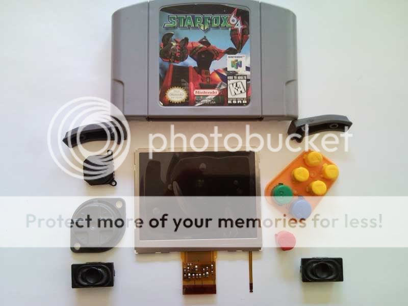

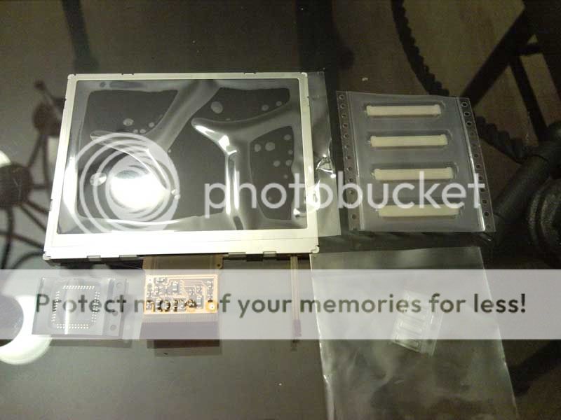

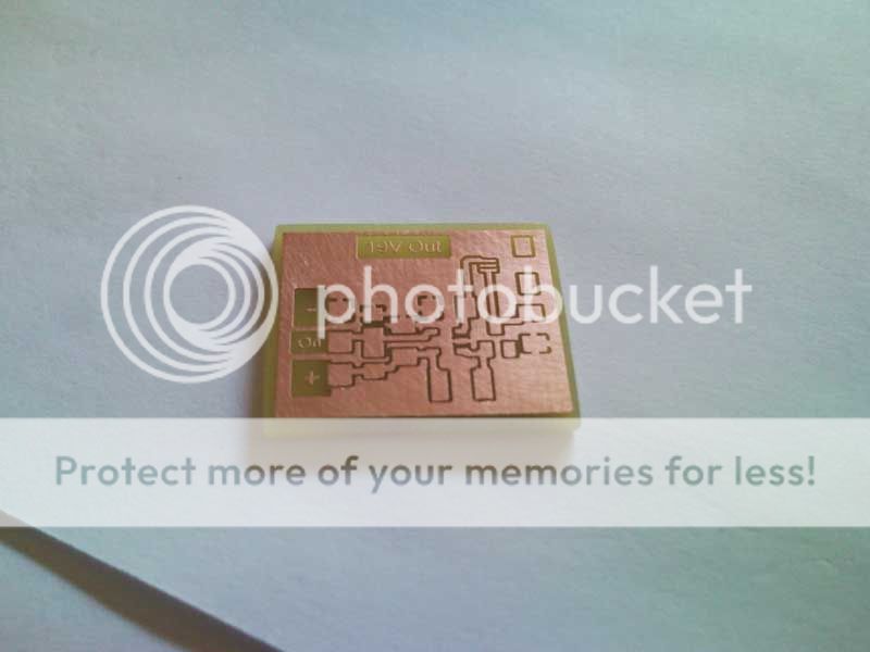

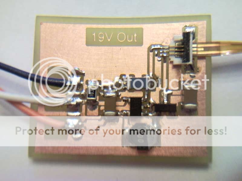

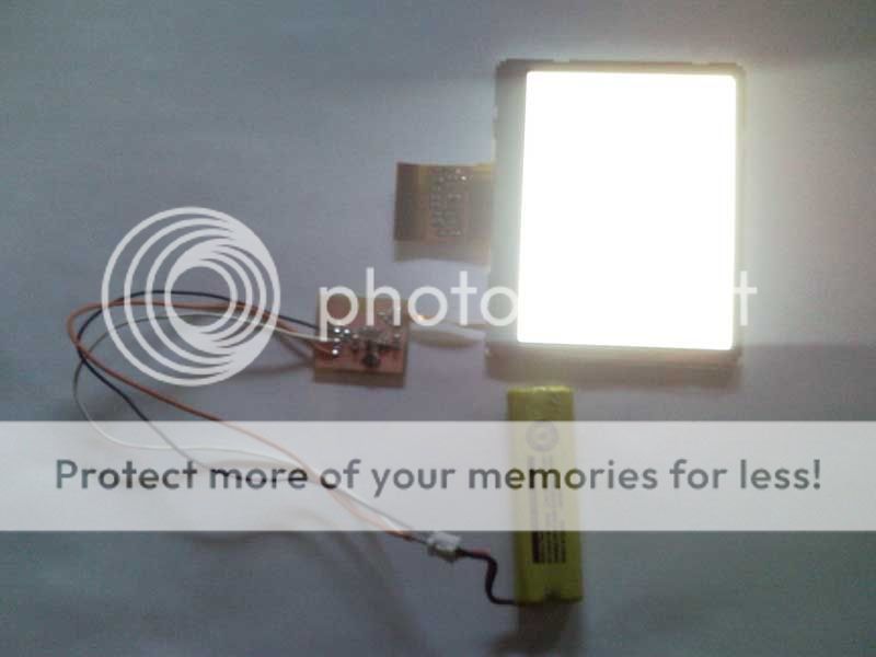

Second, I'm working on the breakout board for the LCD for experimenting. I also ordered and received the parts for the backlight LED boost regulator.

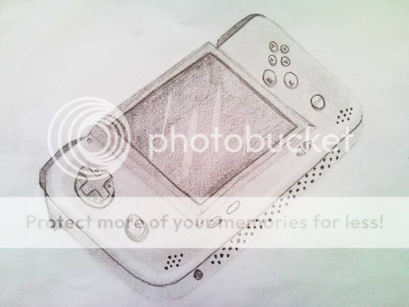

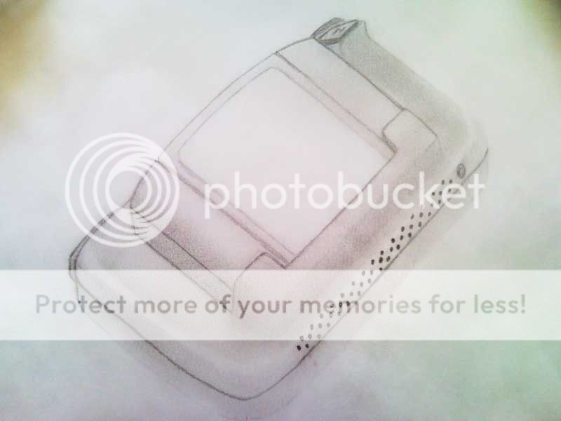

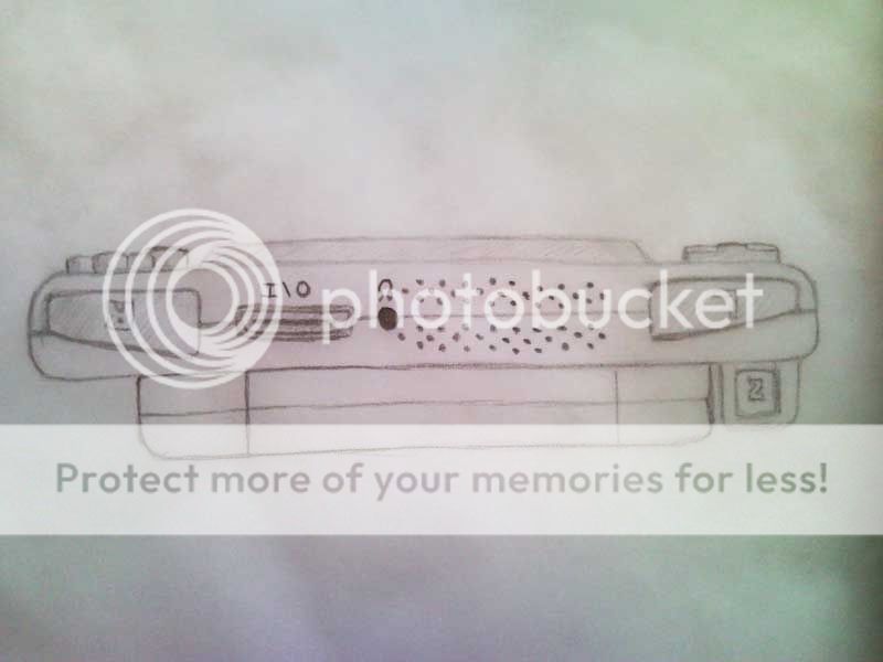

And last but not least, now that I have a pretty good idea of what parts I'll be using for the final product and I know their sizes, I'm starting to get a pretty good image in my head of what the portable is gonna look like, I think you guys might like it.
