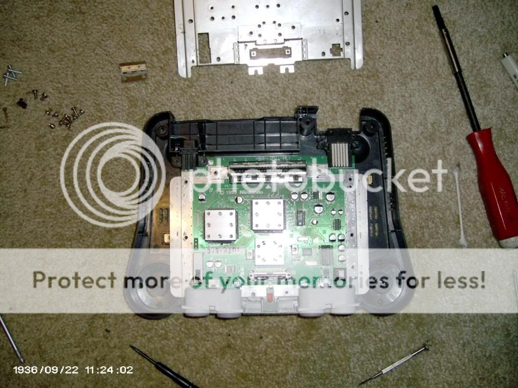

alright, I went ahead and opened up the NUS-CPU-08....
http://i392.photobucket.com/albums/pp5/ ... ln6408.jpg
Serial pic.
http://i392.photobucket.com/albums/pp5/ ... yn6408.jpg
my god... I needed a picture after all those heatsink screws!! some are very stubborn! have to use a special technique
http://i392.photobucket.com/albums/pp5/ ... 8BOARD.jpg
board pic... I'm not sure if I understood your earlier post. Is the MAV-NUS chip only so far known to be in that 05-1 revision?

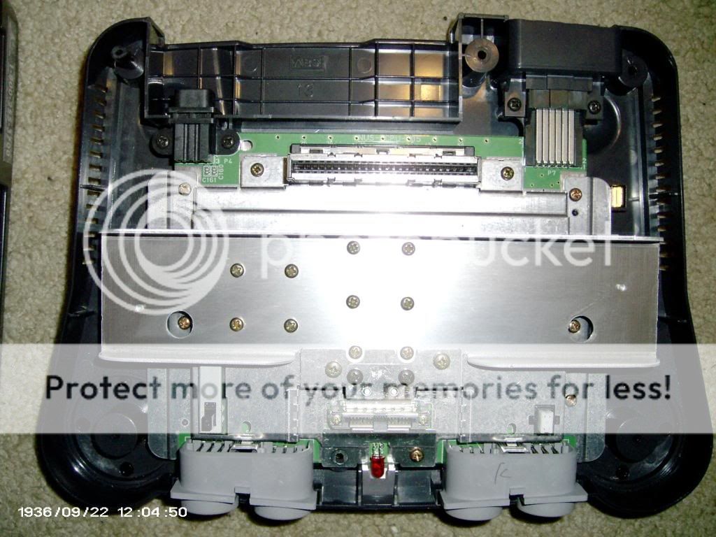

I checked my NUS-CPU-05
http://i392.photobucket.com/albums/pp5/ ... N64_05.jpg
yeah I suck at taking pictures... I helped make it more clear.
The 08 board was printed in 1999.. crazy huh... this n64 was the dirtiest I've ever seen for its age, at least its not horribly beat up though...(there was a little piece of a wood splinter and little plastic rolled up in the area UNDER the system's connectors -where the cart connects... yeah below that tight rowing of pins) just overall nasty. The 05 is almost like new, it even had never gotten an expansion pak put in, the 'DO NOT REMOVE' sticker was still UNTOUCHED when I got it less than a week ago.

No sorry I guess I wasnt very clear, the MAV-NUS video chip was thought to have only appeared in N64 consoles with NUS-CPU-06 onwards, right until the very end of production (NUS-CPU-09?) but this Japan only revision shows that it appeared slightly earlier over there on an 'NUS-CPU-05-1' revision, which appears not to have been released in the US as your 05 revision is right before they switched to the 06 revision, so if an 05-1 revision had been released in the US then yours would have been one, if that makes sense!scikoolaid wrote: I'm not sure if I understood your earlier post. Is the MAV-NUS chip only so far known to be in that 05-1 revision?
Because there it is, in my NUS-CPU-08's board. the whole chips print:
MAV - NUS
BU9906FS
933 198
Yep, PIF-NUS actually stands for "Peripheral InterFace - Nintendo Ultra Sixtyfour" and it actually controls access/data to all the peripherals the N64 uses, such as controllers, memory cards, rumble paks etc. It also has a security lockout chip inside it so thats why you cant play PAL games on an NTSC console and visa-versa (NTSC consoles from US or Japan are exactly the same and the only reason you cant play Japanese games on a US N64 is because of some plastic tabs in the cartridge slot, which you can easily remove)scikoolaid wrote: I saw that other chip called PIF-NUS, could you briefly tell me what that one is?
