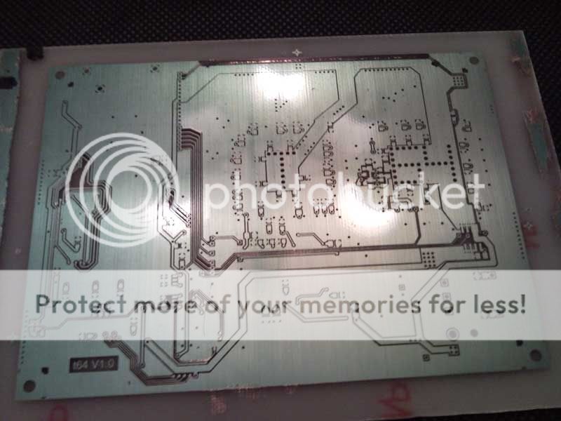

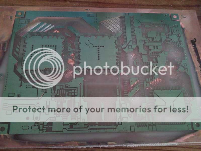

:facepalm: Bad news.....again! I went to etch the board and I used the sponge method. Well, I learned that it's not a very good idea for boards with very fine traces. The sponge is a bit too rough on the really fine traces and it wears out the resist to the point where some traces disappear. Now I can't get another board until next week. :(

Well, I'm certainly not giving up yet! This is the only board I've made that's given me this much headache, partly because I've been trying out new methods, maybe I should stick with what I already know! Darn you guys and giving me new ideas!! *shakes fist* LOL, JK. I thank you all for your input.
I'm determined to make at LEAST the first board by hand as I've never made one this complex. On the plus side of double failing, it turns out that I managed to line up both the top and bottom layers up really well. I drilled out some of the vias on the crap board just to see how well they were lined up and the holes were pretty spot on.

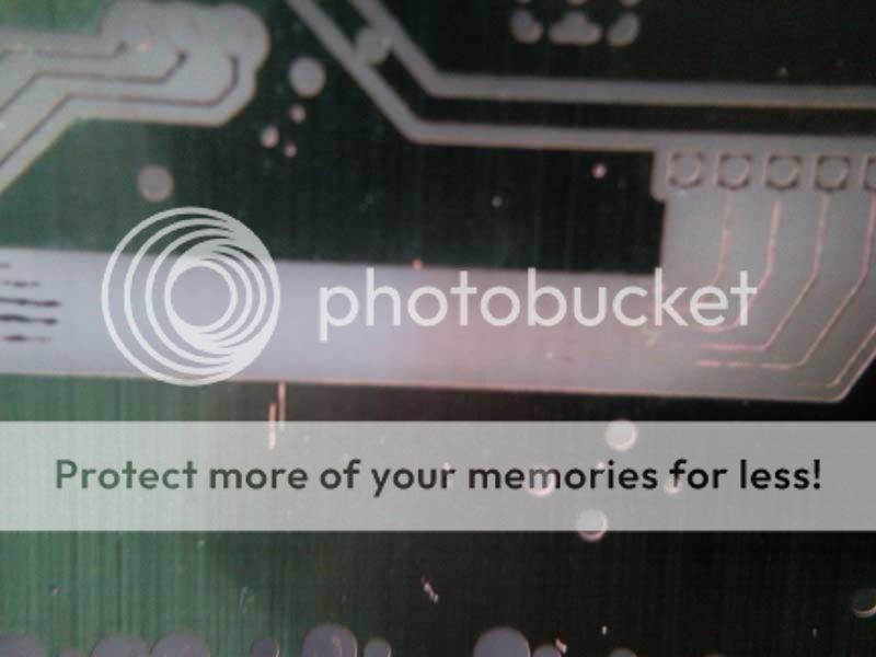

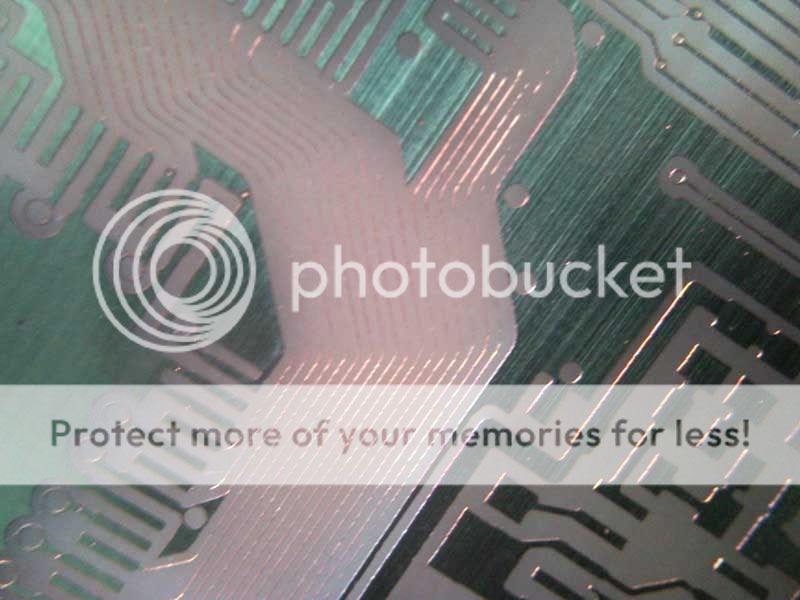

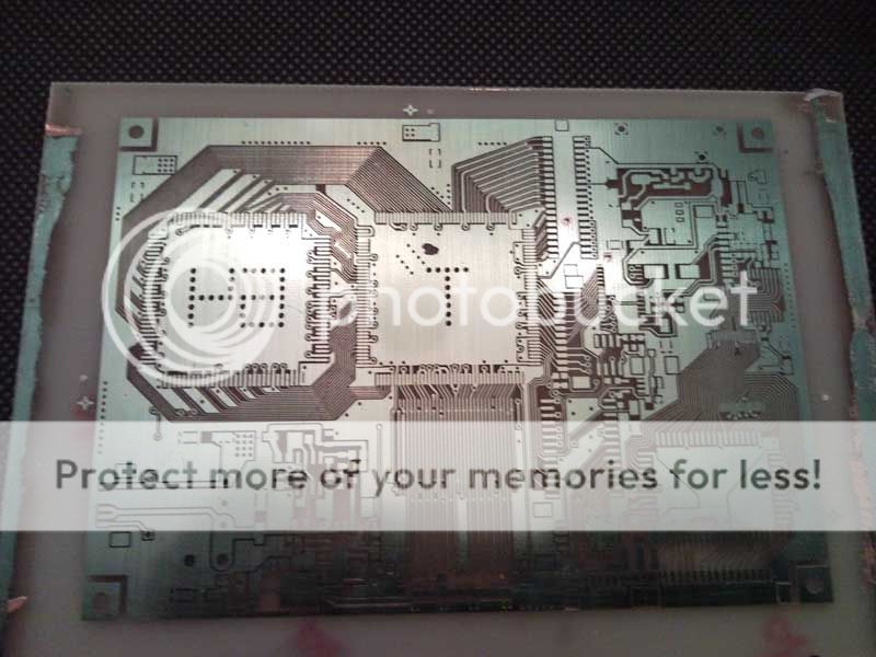

Anyway, I finally got something I can work with. It's not exactly what I wanted it to be, partly because I can't get the transparencies dark enough to only use one and some of the traces turned out thinner than they should have been but, I'm hoping they'll work. It's a start. :|
I kinda had the opposite of what happened last time happen this time where the resist didn't come off enough in some areas so I have copper bridging some traces together. I'll have to go through and manually scrape it off. It's not that bad though, it's better than having too much copper gone.
