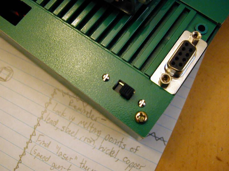

The power switch:

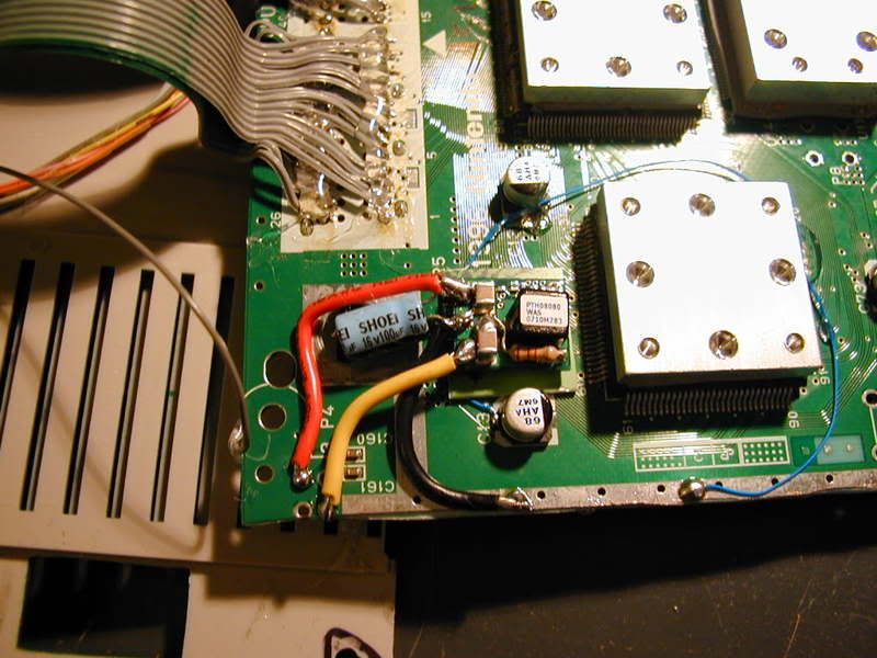

The regulator:

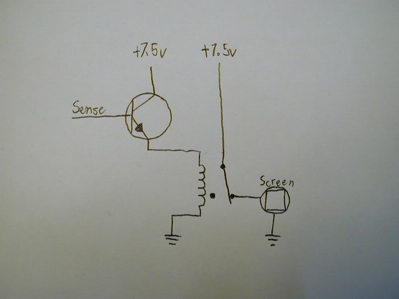

I also installed a little something that turns the screen off when I plug in the AV cable:
Schematic:
The "sense" pin goes to ground for a PNP transistor, to Vcc for an NPN. On the AV connector I connected the shield to ground and used that inside the portable.
