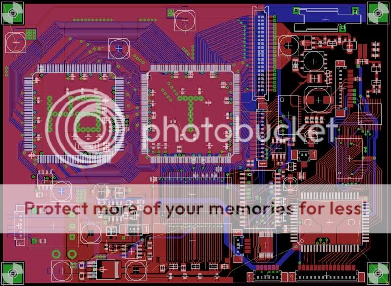

If it was me doing this, I would leave out some components so that the board would be tiny, and then do another board to go under it with other stuff including screen, controller boards, fans, etc., then you would only need to plug in a few things for the back and that's it, still very thin, but extremely small the other way as well. Because right now, correct me if I'm wrong, this board is the same size or bigger as a chopped down n64 board, but it includes all this special stuff that could go on a daughter board.

snowpenguin wrote:If it was me doing this, I would leave out some components so that the board would be tiny, and then do another board to go under it with other stuff including screen, controller boards, fans, etc., then you would only need to plug in a few things for the back and that's it
If I can pull off making the full featured board, I'm planning on making a "lite" version that doesn't include anything that's not required, only the core system. By my guess, it would measure about 9x9 cm.

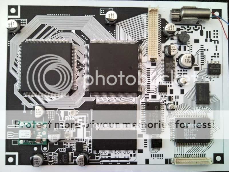

I don't have any updates really other than I would say I'm about 95% done with it. There's not too much more testing I can do on the electronics side as most of what I wanted to test is already confirmed working and added to the board design. I still need to add some of the smaller components here and there and I will post more updates when I have them but, for now, here's some of the latest pics. Notice the little PTH regulator on the bottom left. ;)

Wow, that looks amazing. I'm definitely buying at least one board if you start selling them.

Looks like you're getting a lot of mileage out of the 2layer board! Nice job. Taking a page out of Nintendo's book when it comes to the SysAD bus :)

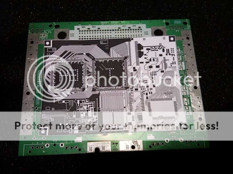

can you take a pic with the printout on top of or next to an originar n64 board, hard to judge how much smaller it is

marshallh wrote:Looks like you're getting a lot of mileage out of the 2layer board! Nice job. Taking a page out of Nintendo's book when it comes to the SysAD bus :)
The fact that they made everything practically pin-to-pin makes wiring stuff not so bad. I remember the first time I opened up my 64 several years back and thinking to myself: "That's it!?" Suddenly, its light weight was explained. :lol:
dragonhead wrote:can you take a pic with the printout on top of or next to an originar n64 board, hard to judge how much smaller it is
Here ya go!

So lovely <3, and its got all the power components to satisfy the N64's odd specs....freakin 3.3, 5 and 12 volts.....

rikitheshadow wrote:So lovely <3, and its got all the power components to satisfy the N64's odd specs....freakin 3.3, 5 and 12 volts.....
Well, not quite. While it is possible to add a 12V step up, I didn't do it only because of lack of space. Besides, the only thing that needed 12V was the audio amp. I'll be replacing that with something else.

Did you make a kind of plug for the cart slot?
I'm guessing its instead of relocation, the cart slot wires will already be like 3-4" long, right?

argelfraster wrote:Did you make a kind of plug for the cart slot?
The cart slot will be relocated and will connect to that header on the middle of the top side of the board. The cart slot will have its own board that it will be soldered to. There will be a cable assembly to connect the two.
