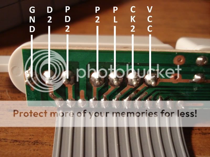

I have some more information about the Retro Duo. Naturally, I have pictures.
Here is a pinout for a 2nd player port. Just connect these to the matching spots labeled on the Retro Duo:

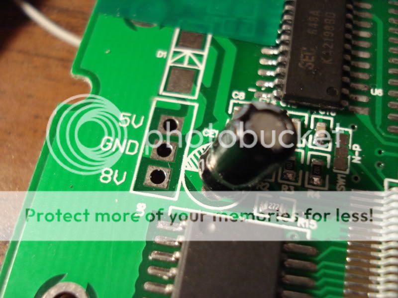

I noticed that the new revision of the board corrected the error regarding where to put 5v and GND:

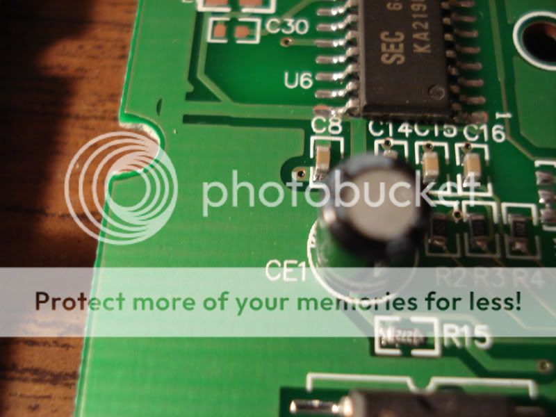

Also, the mysterious place where a 7805 could go for a PAL version is now gone:

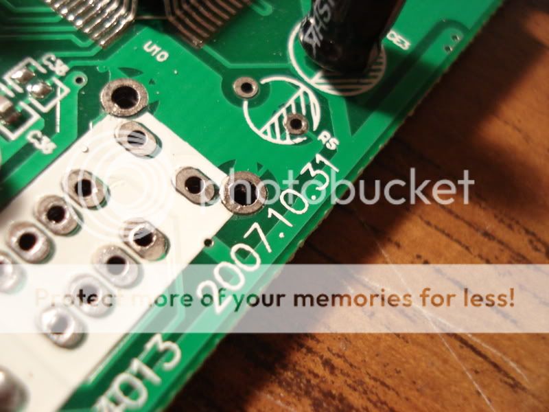

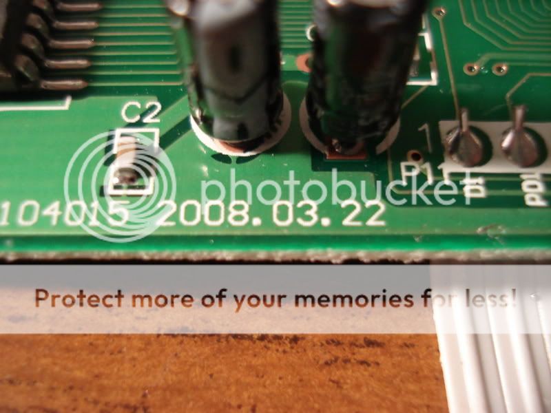

Here's the old board for comparison:
And here's the date on the old board with the mislabeled section and unused pins.
