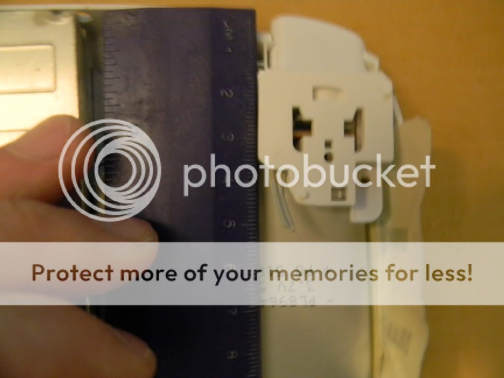

Okay... that's cool. Can you give me the dimensions of the shoulder button mechanism? I'm trying desperatley to find the right battery setup that will fit in my case design.
Ashen
Posts: 191
Joined: Fri May 09, 2008 8:53 am
Location: PA
Re: ~Gamecube Fusion(s)~ Worklog
Post by Ashen »
With all the components hooked up and slimmed like I have them its roughly 5cm tall by 3.5cm wide by 2cm thick. The actual L/R button that sticks out is only 1cm thick

Sure you didn't mean MM instead of CM
That seems very LARGE you're saying that the button is wider than an index finger? The mechanism is taller than 1/2"?

Yep, blue board is the lcd driver board. Those are the exact controllers I orderded. Same seller I think too. Shoulder buttons have a bit shorter range than a standard controller on the linear potentiometer. But overall they work just fine. The controller is also made for the GC.
