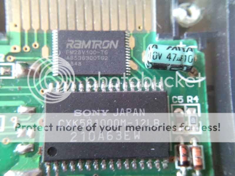

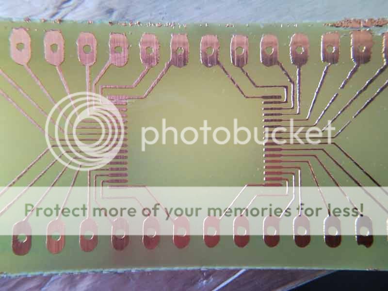

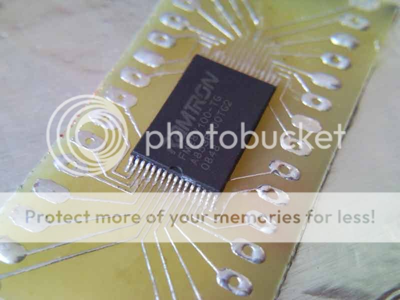

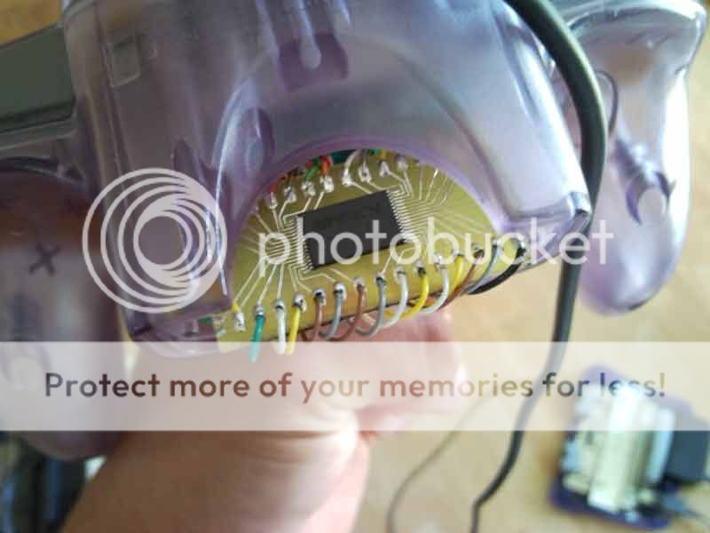

Did some testing of the fan controller circuit and the FRAM chip. Fan controller worked and I'm happy to say that the FRAM chip works exactly as claimed. I had to make an "adapter" for it as it's pins are way too small to solder wires directly to. Then I ran some wires from it to the memory card board where the original SRAM chip used to be. I was in a hurry to make this board so it looks like crap and I had to manually remove some copper that didn't dissolve but, I was pretty impressed that the pads for the chip came out really well. Oh and by the way, I used the sponge method chainfire95 showed me and it took only a few minutes to fully etch the board. When I first plugged it into the controller and turned on the system, it kept telling me that the card was damaged and couldn't be repaired. I had to remove the diodes that originally went to the battery and the 3.3V line and just feed the 3.3V line directly to the FRAM chip and then it worked flawlessly. Here's some pics of it:

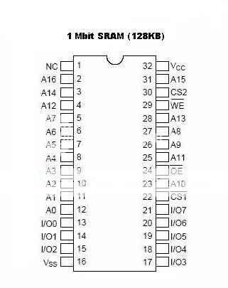

Are the pinouts even remotely similar? Where did you get the diagrams for the N64 memcard?

theyre the same. the fram is a direct replacement for the old chip. but its stable so it doesnt need a battery to sustain the memory.64M320N3 wrote:Are the pinouts even remotely similar? Where did you get the diagrams for the N64 memcard?

Well, I had found the information for the memory card as was mentioned in this thread: http://forums.benheck.com/viewtopic.php?f=5&t=29078" onclick="window.open(this.href);return false; except I changed/added some information.
If you take the pinout for a standard 256Kbit SRAM chip, you can pretty much follow them back to where they're supposed to go and figure it out that way, with the exception of the CS pin, which is wired to a transistor so it was a little tricky figuring out what memory card pins 18 and 19 did at first.
I connected the fram using both CS and /CS pins how I had proposed they be connected in that other thread and sure enough, it worked. Pins 18 and 19 is what I'm talking about. The fram has the exact same pins that a 32 pin DIP, 1Mbit chip has. I used all but address pins 15 and 16, which I grounded for now. Eventually those pins will be used to address the four memory card "pages".

LOL ok. I think they're pretty neat how they work directly in place of an SRAM. The only reason I stumbled upon those chips was because I didn't want to use a bulky 1Mbit SRAM chip and battery holder from a memory card, so I started searching for a non-volatile memory. You can certainly tell the size difference, not to mention that a battery isn't required so the space savings are certainly worth it. Did you order it from Mouser? They also have a 2Mbit FRAM chip with the same number of address pins that I considered using to have 8 virtual memory cards but, it has a 16 bit I/O so It'd require more circuitry, like a multiplexer, to be able to use all of it.stuntpenguin007 wrote:hehe, not trying to be a complete creeper/stalker but I ordered a sample of that ramtron chip so I can finally use my pcb etching stuff
Here's a comparison of the FRAM to the SRAM I was thinking of using at first:

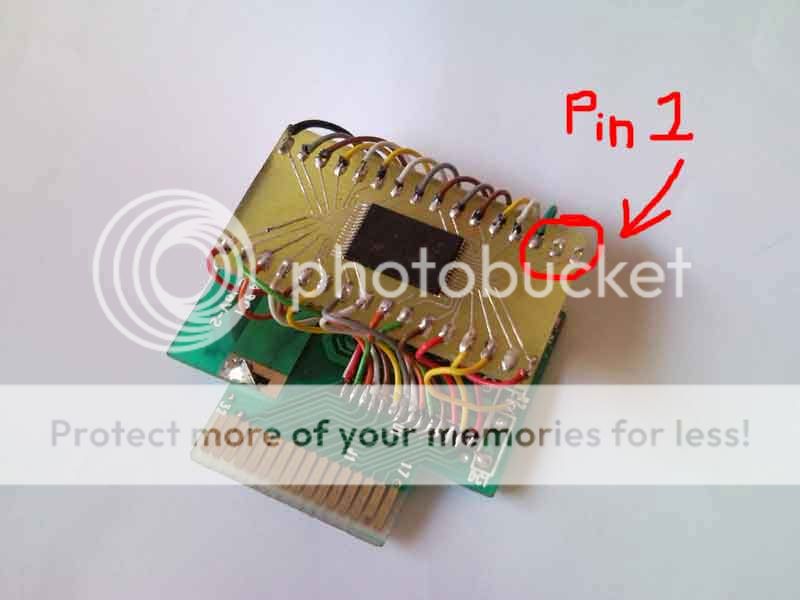

In your custom memory card, are the top left 2 pins connected or not?
Oh and I'm pretty new to eagle. What did you use to make the pads you soldered wires to? Pic Microchips don't seem wide enough.

If you're talking about these:stuntpenguin007 wrote:In your custom memory card, are the top left 2 pins connected or not?
Pin 1 isn't used for anything. Pin 2 is address pin 16 and pin 31 is address pin 15. Those two pins I connected to ground for the time being but, they are not pictured as I did that after I took those pics.
This is the pinout for a 128 KB SRAM chip. This pinout matches the pins on the adapter.
