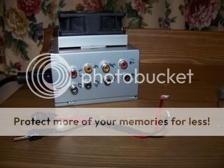

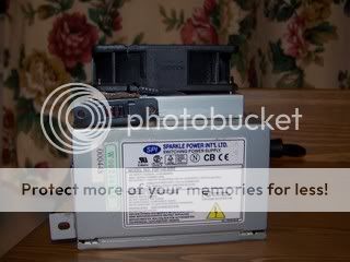

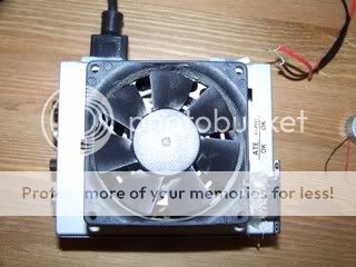

Ok, I collect crashed computers and save the parts from them. I got a PSU from one, and decided to make a desktop PSU with it. Due to the small size of the PSU's case, everything is crammed in. Because of this, I had to mount the fan on the outside instead of being inside, taking up space. For the Plugs, I used old A/V plugs, and the power switch is...get this...from another computer PSU. To get the 8 volts, I used a 7808 regulator from a dead circuit board.
From left to right: 3.3v, 5v, 8v, 12v. The bottom row is all ground.
The side with the power switch.
The fan mounted outside the case.

Oh, badass.Why no 9v?
That's kind of... standard in everything.

jjhammerstein wrote:Oh, badass.Why no 9v?
Because 8 volts is close enough to 9, and due to the vey limited space, there was not enough room for two more plugs.

How hot does it get?
themadhacker
Posts: 2670
Location: ohio
Post by themadhacker »
Not very. There are holes on one side of the case which the air from the fan can circulate through.

Are those RCA jack outlets?

ground is common, you could have just used 4 RCA plugs :lol:

It would look a lot nicer if the holes were lined up and like triton said, you only need one ground plug.

Triton wrote:ground is common, you could have just used 4 RCA plugs :lol:
I know, but with more ground plugs, I don't need to make a stretch with the wires I plug into them.
