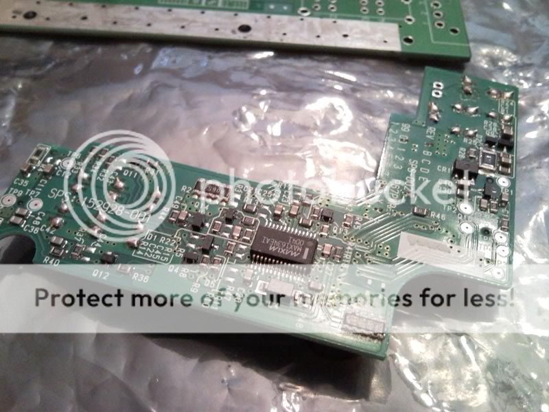

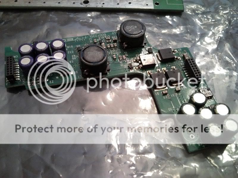

The SMPS I'm using was removed from a laptop. It contains both 3.3 and 5V regulators and can be turned on/shutdown with two pins.

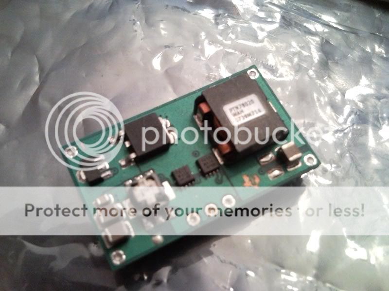

This is a Ti PTN78020WAH regulator that I was originally planning on using instead of the 3.3/5V one but, I'm probably not going to use it for this project now.

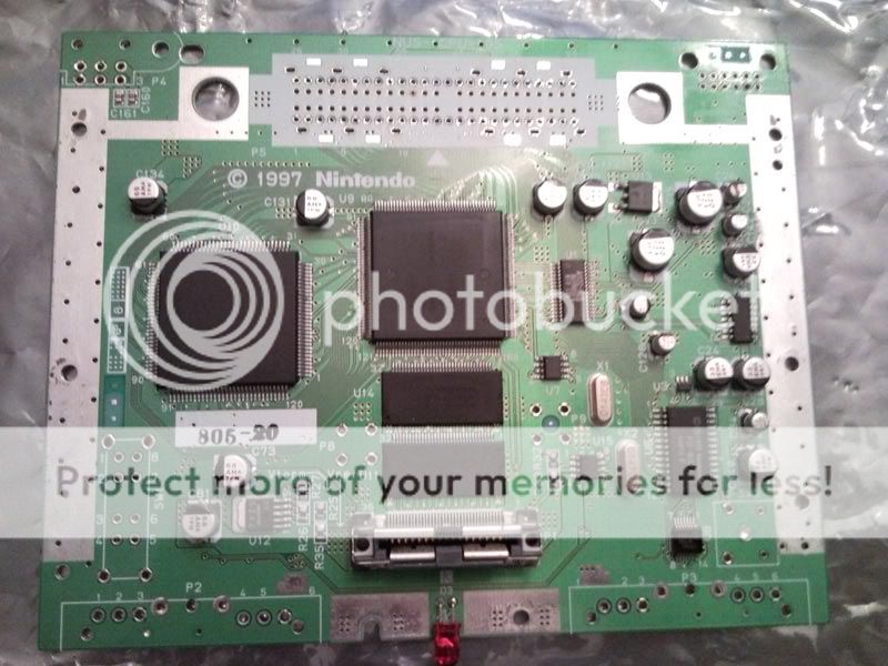

This donor N64 contains the AVDC-NUS Audio/Video DAC.

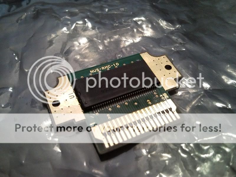

I'm going to use two, 36Mbit RAMBUS chips but, I still need to get my hands on another expansion pack for the second 36Mbit chip.
I was going to use the two, 18Mbit chips and one 36Mbit chip but, that would be counter productive.
This is after removing all major connectors from the board.
and bottom.
This is after removing the DAC, PIF and quad buffer.
This is after removing everything else.
And last but not least, these are all the chips after being removed.
