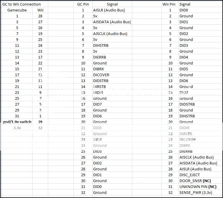

Post by hackmodford » Fri Mar 18, 2011 10:47 am
It has been shown that you can use a wii disc drive in a gamecube... infact you can use a wiikey in a gamecube...
