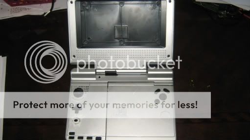

So i came up with this name, with the help of my brother, because of the system's shape and resemblance the Gameboy Advance SP
The screen in there right now is a 7" but i'm replacing it with the PSone screen.
The buttons are on the sides(duh) and there will be spots beside the screen where the buttons will go when closed

Dimensions: 20.5 x 16 x 5(cm)
Open: This is how it got its name :lol:

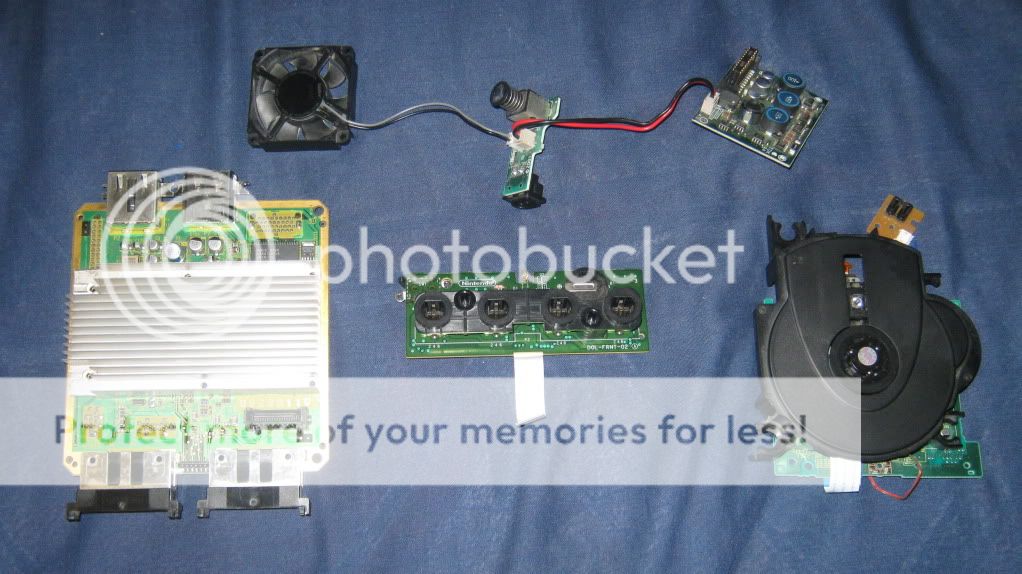

Disassembled Gamecube: REV A mobo :(

Where the old DD was, but moved a little to make space for the buttons.
There is a little flip open lid to put the usual DVD
I also finished cutting the holes for the buttons :)

:lol:Funny you mentioned that. I realized today that i cant relocate the DD mobo so what i'm going to do is extend the (black) bottom section with a 1cm plastic strip all the way around the edge
This will provide extra room for the L/R triggers and the DDmobo. I thought of cutting the heatsink a little instead of extending it but i don't want to risk the system over heating.
But the actual DD fits in nicely(if extra plastic is trimmed) but it sorta needs the mobo as well. :lol:

Okay, so i'm not going to relocate the memory card slot. Instead it's going to be pointing out the back.
Today I put the R/L triggers from the Gamestop controller on the bottom :D and they work nicely.
Also I trimmed the ground side sections off the mobo to save space.
