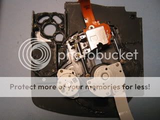

It's been a while since I posted now. I've been crazy busy with school and work.
Anyway, today I had the opportunity to continue my work on my Gamecube Advance SP again so I have an update :D
So today I did two things; I installed the cooling fan, and relocated the potentiometers for the R/L Buttons
Also since my last update I installed the Disc Drive :D YAY!!
And everything pictured here(with the exception of the buttons which can be screwed into place on the upper half of the case) is screwed in place for easy access.

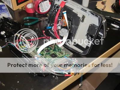

Update! That's right this thing is still kickin' :D
I've been working on this on and off for a while and will be looking to sell it in the near future so I want to try to finish it up by the end of October or early November.
The motherboard I was using was fried so I bought another and replaced it. This one is a rev C board so its better :) I kept the metal heat-shielding and trimmed it down to fit inside. This will create a more direct airflow once I put in the secondary fan at the end of the heat sink, as it will keep the air from going out of the top of the heatsink and just out the end and directly out of the system. I also replaced the player 1 & 2 controller ports so that it was much cleaner and nicer looking. As you can see from the pictures below, I have hooked up the A/V cables and extended the original lid switch. I will be using the lid switch as it was designed so that when the disc drive opens, it'll be the same as a standard Gamecube.
Also, does anyone know what I will have to relocate to be able to cut here? This is a rev C board and I need this space for the disc drive laser to fully extend.

 Post subject: Re: Gamecube Advance SP - Update
PostPosted: Sat Jan 07, 2012 7:15 pm
Offline
Joined: Sat Jan 07, 2012 12:24 pm
Posts: 7
to start off with:
Damn you have f'ing great cutting skills...
Also, damn you for having similar ideas to mines xD I had tought my GCp with the round logo jewel on top and SP styled, when my mod starts to get some picutres plz don't think I copied you, but sry anyway =)
at the Potentiometer question I think you need a 1k one if I'm not wrong. If I am PLEASE someone else correct me.
about the "triangular" cut you wanted to do: viewtopic.php?f=59&t=42403&hilit=gamecube+memory+card+wire
Acording to what I understand from there, looks like there's no wiring needed, if there's any I'd say it's that "thick" line youre be cutting trough on side A as there's absolutly nothing on side B.
Wish you luck with that, youre's is actually one of the most interesting GCp projects arround. congrats
