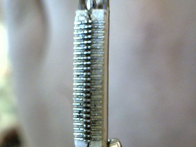

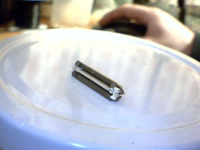

hey everyone, again i just have a little update for you on some recent innovations with this project. i came up with a variation on hailrazer's ribbon cable extension method http://forums.benheck.com/viewtopic.php?f=41&t=33728" onclick="window.open(this.href);return false;. first of all, im sure that method funtions perfectly fine, but i was never really sold on the idea of jamming two 24 pin .5mm ffc cables into one slot, firstly, because it puts extra stress on the zif connector, and second, because those contacts are so small, and so close together, that it just seemed all too likely that i might make a mistake, and they would short out. so with all that in mind i designed this:
taking a few old laser modules from other dead PS2s (i had a lot), i used a clothing iron to desolder them from their boards, lined them up and soldered them together, pin to pin. i may or may not do the same for the 12 pin 1.0mm spindle motor ffc, just because the contacts are far enough apart that it shouldn't pose a problem. anyway i hope you like my idea, this concludes our broadcast day.... click
