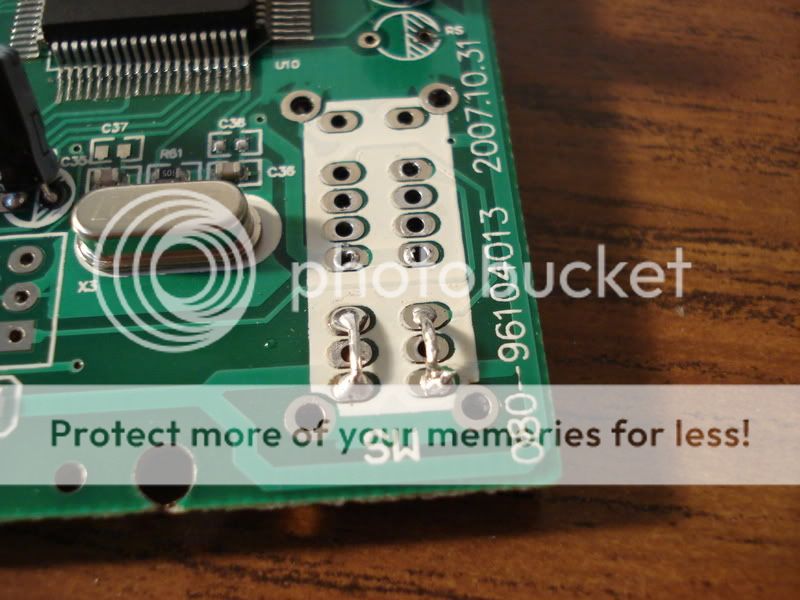

More hacking info! Assuming you're using just the SNES portion for a portable, here's how you bypass the power switch after it's been desoldered:
I think you can get away with only jumping either the left or the right but since the main power goes through here why limit the current?
You can now put a switch of your choice between your power supply and the power input of the board.
_________________
