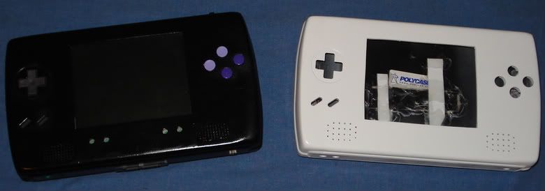

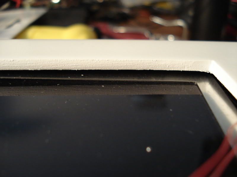

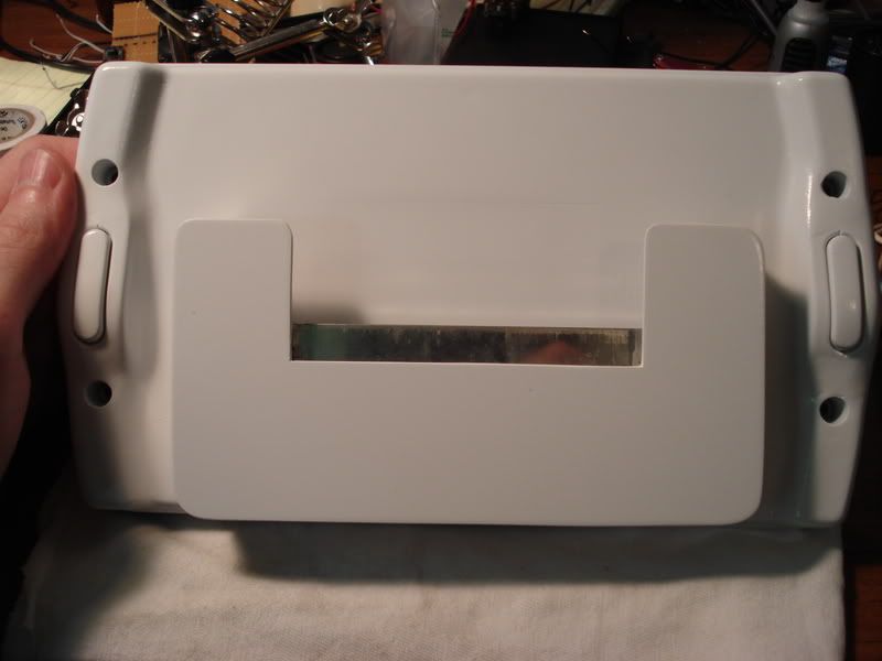

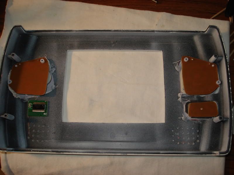

Looks cleaner, no? I need advice for really good clear coat to protect the white paint job. The paint job isn't finished yet (still a few more coats and a lot more sanding to go), but I just wanted to compare the two. The patched hole on the back doesn't look pretty from this angle, does it? This portion will be inside the case and under the SNES mobo when I'm finished so it will be like that hole never existed.
Okay, so I lied - I haven't checked to see if an N64 or a GameCube would fit in the ZN-40 case yet. I'll get to that... eventually. Just check out the dimensions on www.polycase.com for yourself or simply take neildo's word on it. I'm going to go play me some Super Metroid - it finally arrived in the mail today!

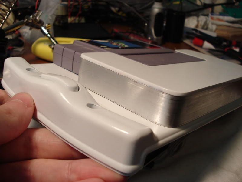

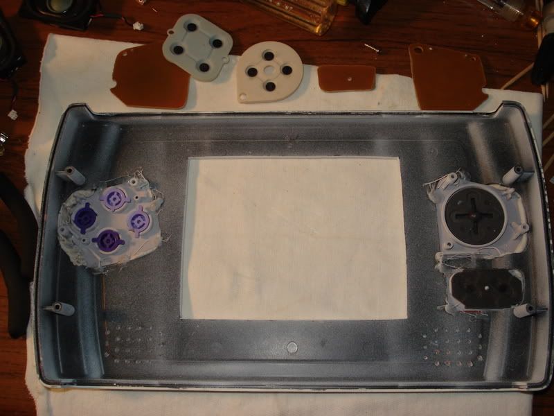

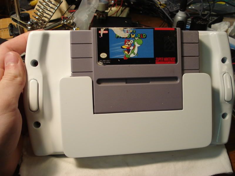

Disregard the red and green wires - it was easier to leave them attached.
I'll be cleaning up the metal parts next. Very fine sandpaper = brushed aluminum!
This copy of Super Mario has been sitting in my garage for a very long time. I use it to align things when building.
It's got a next-gen Nintendo feel to it, doesn't it?

just a little note on the n64 fitting in a zn-40. They do fit but you NEED to trim the board.
Top
 Profile
 Post subject:
PostPosted: Fri May 16, 2008 1:11 pm
Offline
Portablizer
User avatar
Joined: Sun Jan 29, 2006 9:09 pm
Posts: 852
Location: Iowa
Where do you need to trim the board? I'm making a PN64 with this case and it fits perfect. If you check the dimensions people have for the N64 board and the dimensions on the site for the zn-40 case, it is just barely too big. I figured I would trim my board to fit but when I checked it, the board fits perfectly.

Looks professional. Interestingly enough, Nintendo SNES cartridges look different in the UK (PAL). PAL carts are curved; got this pic off Google images:

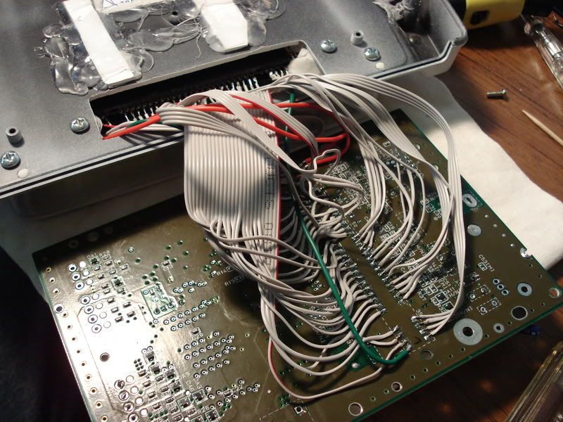

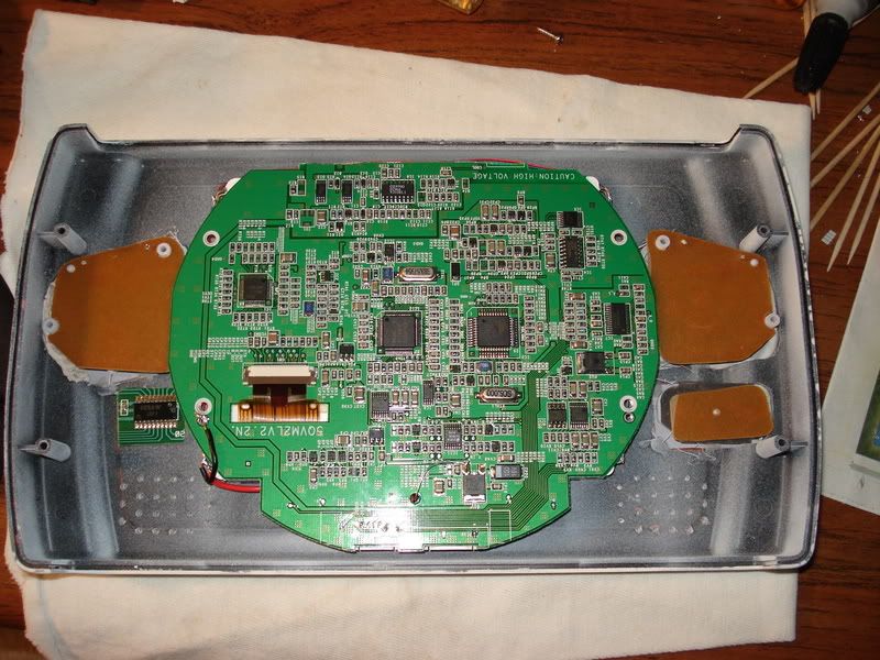

Amazing - it all fits. It's like I planned it out or something.

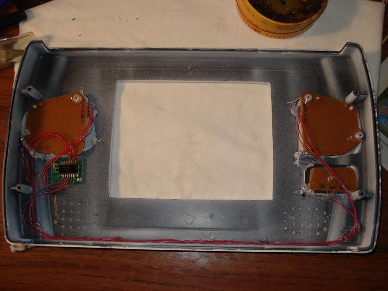

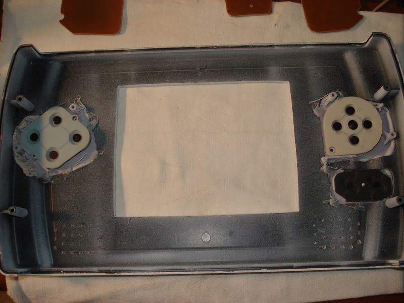

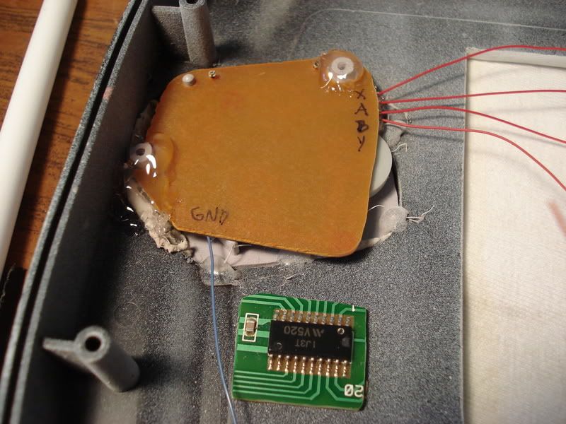

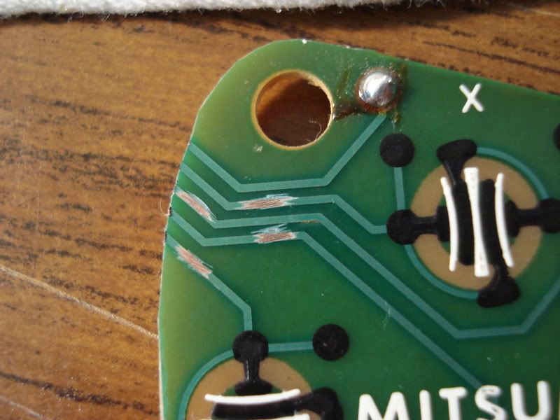

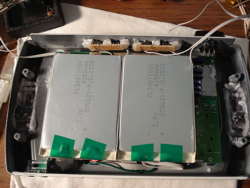

To attach wires to controller boards: Scrape traces like so, smear a little bit of flux on them, and then put a little bit of solder on the traces. Your wires will then stick to where you want them to.

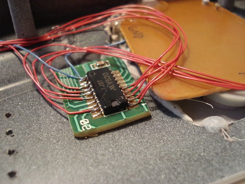

It's important to stay organized and take notes when possible:
How's that for meticulous wiring? :D
These batteries are amazing. Got them from batteryspace.com.
I stacked everything together and put on the front lid to see if it would all fit, and I still had about 1mm clearance as shown by this picture:
The volume and brightness controls have been relocated to the top of the case:
And last but not least, here's a new Youtube video where I test the controls and make sure the cartridge slot is still good even after shifting things around a lot.
All in all, this represents about 6.5 straight hours of work today.
