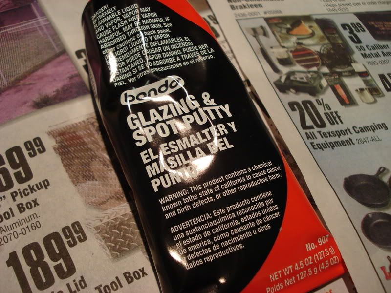

I don't know about anyone else here, but I found that I am allergic to unhardened spot putty. When it hardens/sets, it is fine, but I got some of the stuff on my arm while I was working and I developed a HUGE rash...
Gloves ARE a good idea.
- Juice 8)
Yeah, you probably don't want to get any of this junk on your skin... It didn't bother me too much the last few times I just used my finger to spread it, but why take chances?

I have used that a lot (exact same thing) with just bare hands and I haven't had any problems with it, besides the fact of having reddish fingertips until you scrub it off sometimes. It says on the tube that it is a skin irritant and may be harmful if absorbed through skin, so It can't be good.

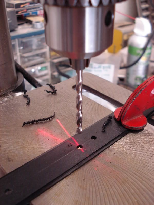

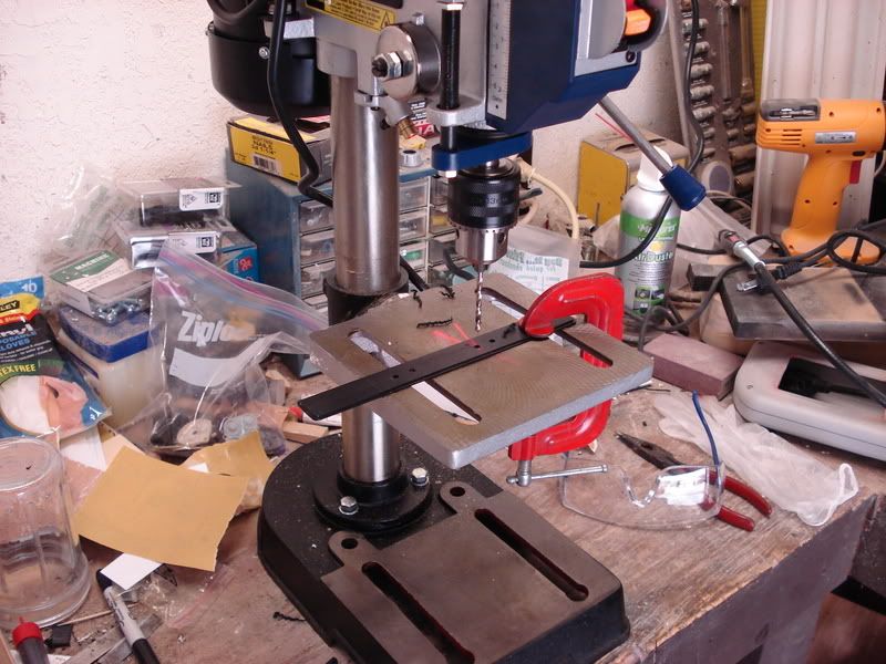

I found a drill press on sale for $35! I was skeptical at first and half expected to need to return it, but it's actually quite nice! Small, but that's just what I needed for my type of projects.
LAZER BEEMS! PEW PEW!

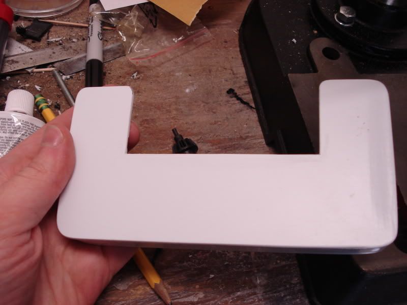

I'll need to add some more spot putty here and there and do some more sanding. The primer helps me see the uneven spots because of its uniform color.

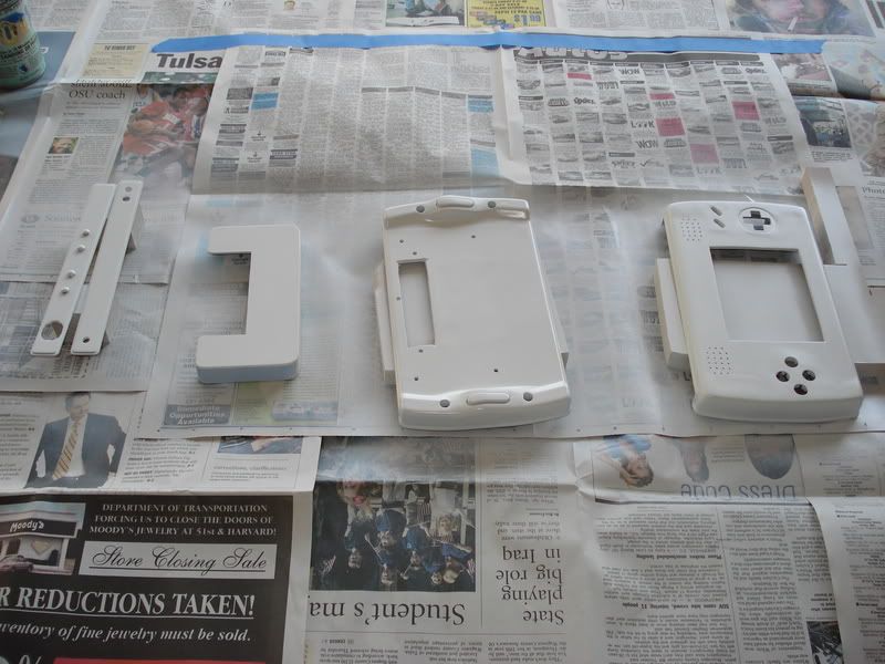

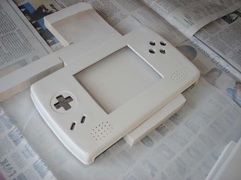

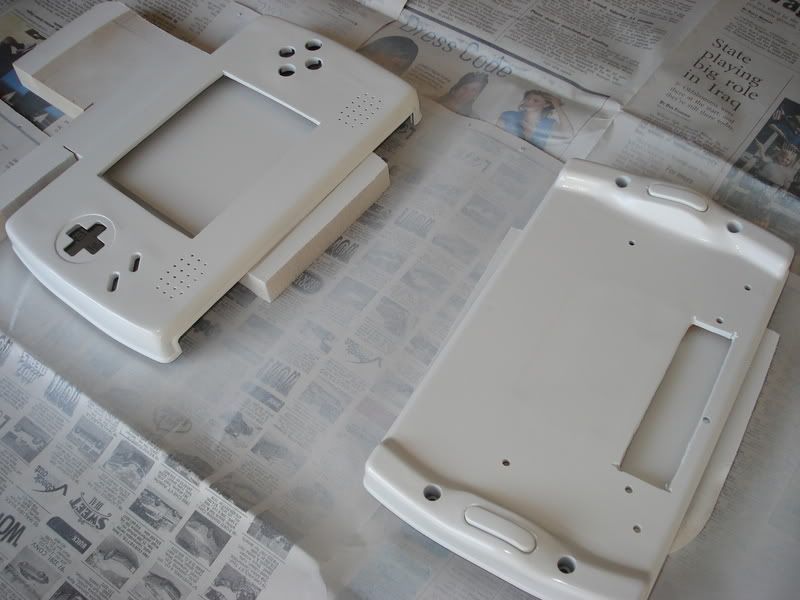

I just put the first coat of paint on. I took these pics while the paint was still wet so it looks shinier than it's going to be. I'm using satin white Krylon Fusion paint. The primer was kind of old and consequently blew little chunks here and there while I was applying the second coat. I sanded it down in those spots and then put this first coat of paint on. I'll be doing a lot of very fine sanding to get it as smooth as I'd like.
I know, it doesn't look much different from the primer alone in these pictures but it's getting better all the time.
