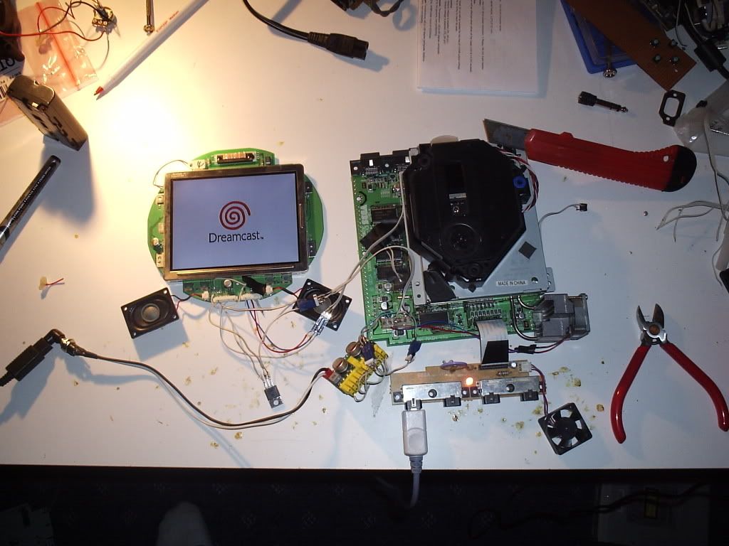

I just bought a regulator, and I don't really know how to use it here's a diagram :
I beleive Vin is the 12v in (duh!) and Vout is 8v out (duh!2)
But What is ADJ for ?
And must I ground the screen I power up with this regulator with my PSU ground ?
Thank you !

ADJ I could assume would be adjust. Meaning you might be able to control the voltage. Don't know for sure been a while since I've used a 78** regulator or something like it. If you are unsure, and you don't get an answer contract gannon he'd likely know.

I'll try like I feel it, I have 3 regulators and they are all 8v and I can't fry my psone screen since I read that some ppl tried it on 12 v here ...
EDIT: connecting the screen's and dreamcast's ground togheter, the right pin to 12v in and center pin to the 7.5v in of the screen didn't worked ...
Can someone help me with regulators ?

[EDIT] I Just make it works, I found the pinout somewhere :P
It now all works from the 12v, but the regulator is getting PRETTY HOT, I think I'll put the controller's port fan and fix it to the regulator to keep it cool :P
If someone know a better way to cool it, tell me !

I got problems with my Regulator, it got pretty hot.
So I made a "DoubleFannedSupraExtraMediumEfficientCoolingSystem"
Wich is simply the regulator trapped between 2 fans (and 1 kind-of-radiator)
It works pretty well, no more reset due to heat ! :lol:
Now my desktop looks like this :
High def: http://i84.photobucket.com/albums/k19/_ ... tv_0-5.jpg

Well, it'll looks like almost every portable, (gameboy advance style with the screen between the controller, and a bit like the gamecube portable Turbo Tax 1.0 made (thickier where the mother board is and more slim where the controllers pcbs are !
I don't feel like drawing it right now.
The case is gonna be vacuum formed if I do it before June, and if I do it after, I'll be done with the Ben Heck's style.
[EDIT]
I just passed th day trying to make it more slim like the first guy who made one did !
... I found a (hardcore) way to do it, i'm half done ...
Look ...
High def: http://s84.photobucket.com/albums/k19/_ ... tv_0-8.jpg
-=FamilyGuy=-
