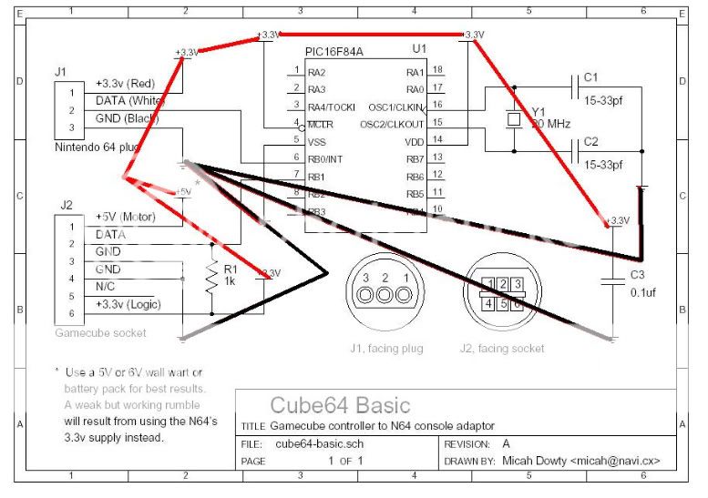

Post by stuntpenguin007 » Thu Apr 30, 2009 6:19 pm
I have all of the parts now except for the gamecube socket. Now I have some questions about how I should be hooking things up. I've done a little scribbling on the schematics, so the black lines are ground and the red are possative. anyways just tell me if this is correct.

Post by marshallh » Thu Apr 30, 2009 6:46 pm
Yup that's it
