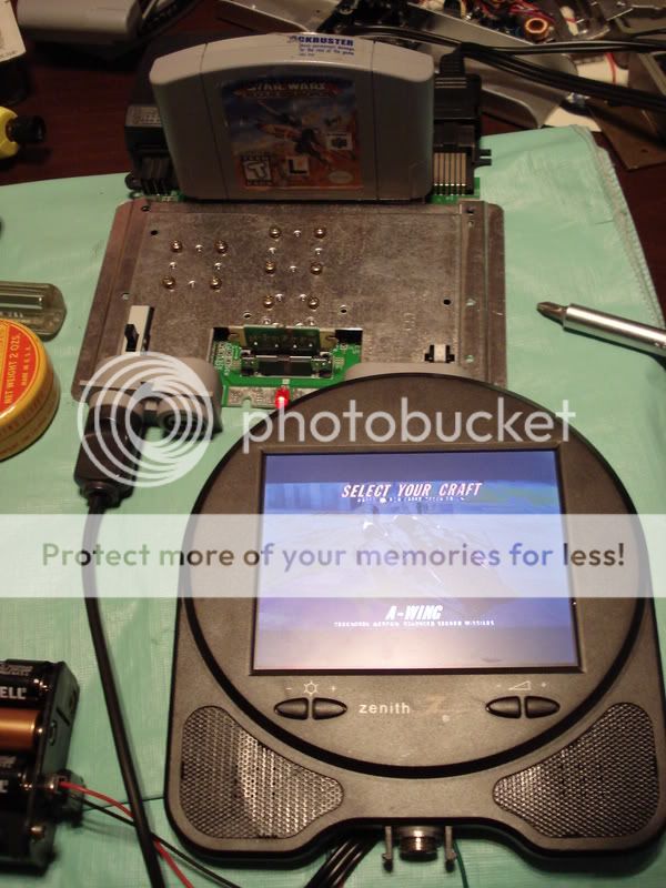

Brian connected an N64 to a small portable screen for the first time! What could possibly be next!?
I played some Rogue Squadron until my AA batteries I used to power the screen for "testing" ran out... :lol:
That's the screen I won from the last contest, by the way. You can see I'm finally putting it to good use.

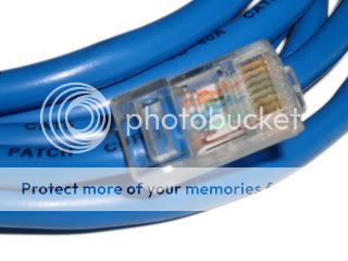

I'll give you another hint - I've been playing around with a couple of RJ-45 ports and some Cat 5 cable. What could that possibly be used to connect?

Here's my theory with the rj45 cable and two pths. You are making two n64ps consecutively and you need a regulator for each one. The RJ45 will be a link cable on which video and audio will go from the master (running the game) to the slave and the controller connections will go back in reverse. You don't even need eight wires for that so I hope you will do something where you won't even need to flick a switch for the 64s to run in link mode. I'm thinking a signal down line 8 that when high (aka plugged in) switches the slave which is off into slave mode. Use transistors or whatever method you please. If that is confusing what I mean is Plug in 64s turn on 64 with game in that will send a high signal down line eight which will switch transistors so that the n64 mobo on the slave is turned off the video switches from internal to the RJ45 signal and the controller switches to going out externally and acting as basically an external video unit with controls like techknott made for his xbox.
Of course I could be wrong.

@ evilteddy: Bingo! You actually thought it out a bit more than I had. I only need 6 wires to connect the two (video, r audio, l audio, ground, controller data, 3.3v for controller 2) so I think what you suggested is do-able.
