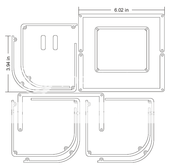

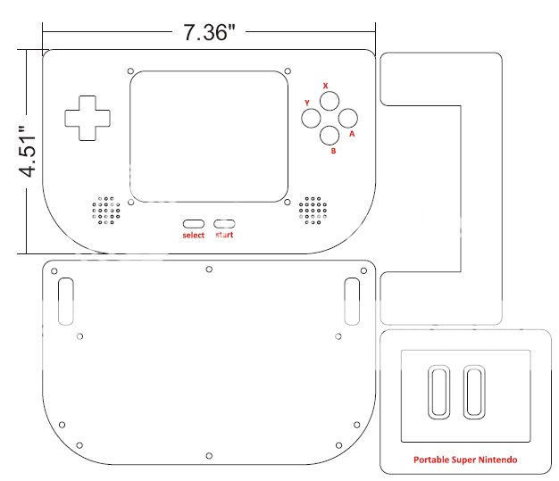

Some more info:
FC Twin
3.5" AEI Components screen
3.7v 3200mAh LiPo battery (going to boost the voltage to 5v)
stereo audio amp w/ headphone jack
relocated cartridge slot
Front and back plates are black acrylic with white engraving
Sides are clear acrylic
Case designed by me (heavily inspired by Ben Heckendorn's designs), case cut by Pololu.
I'm really looking forward to how the case came out. Should be here in a few days. I spent about a week obsessing over the design, but decided to go with this draft. I will post info about the voltage boosting circuit and stereo audio amp when I get to them, if you all would like. Thanks goes to Rekarp for pointing those out to me.
