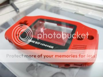

[UPDATE ###FINISHED###]______________________________________________________________________
Im Done!
[Update]_______________________________________________________________________________
so i took you guys' suggestions, and just used Krylon fusion.
this isn't the real one, i just used one of my old and broken shells to show the color i bought.
[ORIGINAL]_______________________________________________________________________________
i wanted to extract the colour out of my GBA case and then dye it. I have seen this done with a macbook. http://www.macmod.com/external-mods/ibo ... w-ibook-g3
im buying 91% alcohol today. can anyone tell me if im doing it right?

Re: Gameboy advance Dye
Post by eagle5953 »
I think that would be unnecessary. If you take the time to do it right, the Krylon Fusion paint mentioned in your link should be all you need.
If you google around a bit, however, you may find that you want to try an automotive spray. It is a type of dye that chemically bonds to the plastic instead of just coating it. It's easier to screw up but looks better in the long run.

Krylon Fusion should work OK on the plastic, it bonds right to the plastic and isn't technically a paint but a pigment. Using a white GBA to begin with is a very good idea, it will save tons of time. And the soaking in alcohol doesn't remove pigments in the plastic, it can only remove paint. It also removes and dirt or things sticking to the plastic which would prevent the dye from acting on the plastic.
Another possibility is to use vinyl dye, the kind they make for car tops and such. Here is a link to a guy who used electric blue vinyl dye to paint a Tandy 102 (my favorite old school computer)
http://www.chuckthewriter.com/tandy.html
I have used vinyl dye before, and I would say it beats RIT for sure, and seems to be less tricky to use than Krylon. The problem really is finding it in the color you want.

palmertech
Posts: 3225
Re: Gameboy REDALERT Advance [UPDATED W/PICS!]
Post by palmertech »
That is... Beautiful. :cry:
I love Krylon fusion so much. :mrgreen:

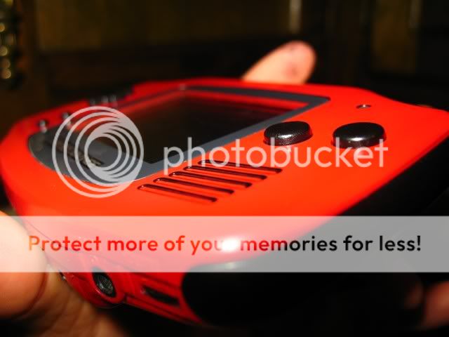

attacknick
Posts: 107
Joined: Tue Mar 03, 2009 4:29 pm
Steam ID: attacknick
Post by attacknick »
yea, i thought the same thing. the real version won't have red accents. 8)
too broke to make a portable.
eagle5953
Posts: 1892
360 GamerTag: eagle5953
Steam ID: eagle5953
Post by eagle5953 »
Looks spiffy! I love Krylon Fusion as well.
I agree, though, that you need a second color to give it some balance.
