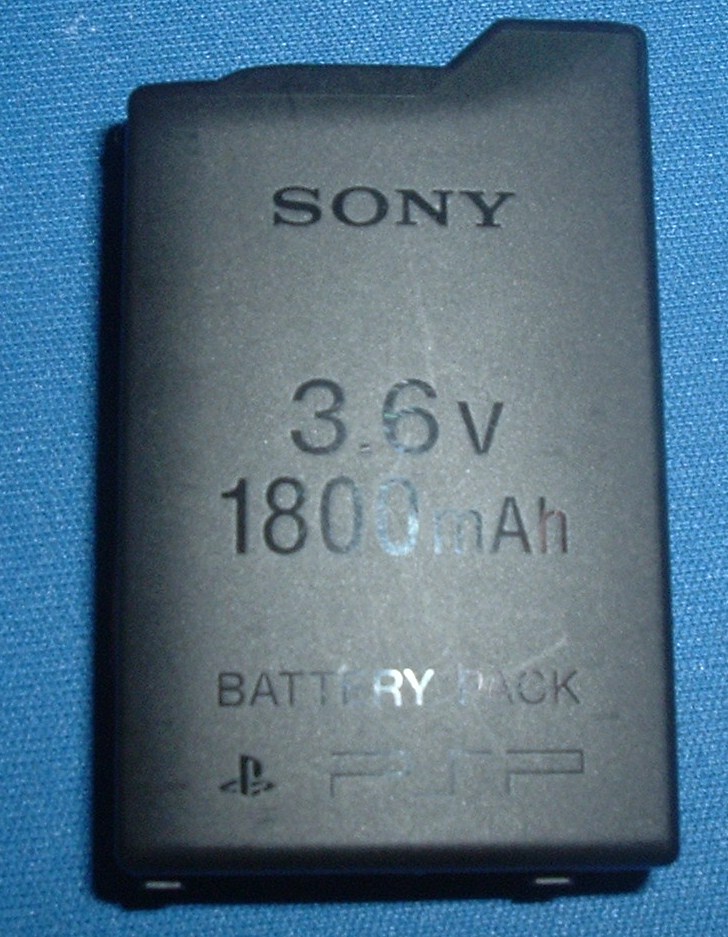

heres my issue.
I know how to solder adn all that jazz, and I;m very familar with a PSP...but...
my battery has no board like yours shows, its a 3.6 1800mAh Sony Battery Pack, bought from BestBuy.
All it is is a battery and a board on top
I figured out which chip it is that i need to unsolder, my only question is, will it work with a battery that doesnt have the big chip

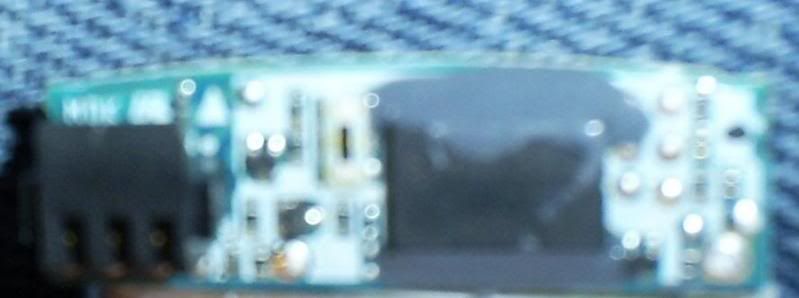

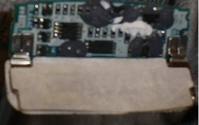

So I'm still new to this, but i am experienced at soldering so when i herd about this I was very happy, but my problem is my official PSP bat does have different insides here's some pics.
(Bad pic of the Board)
http://i4.photobucket.com/albums/y103/g ... spmobo.jpg
(Under side of bat Board)
http://i4.photobucket.com/albums/y103/g ... spbbat.jpg
(Better pic of bat board)
http://i4.photobucket.com/albums/y103/g ... pspbat.jpg
(Bat cover showing official PSP Bat)
http://i4.photobucket.com/albums/y103/g ... batcov.jpg
So basically its the same one (I'm guessing) as Bobtentpeg
Question to Bob though does your bat work after you took the cover off?

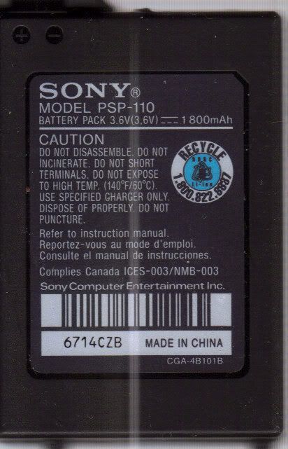

Bobtentpeg wrote:heres my issue.
Yeah, I have the same problem. Battery is a PSP-110 original that came with the PSP, 1800, 3.6, but the board is VERY small, (fits on top of the battery core pack) and there is no IC like the one mentioned in the directions. How many different batteries are there? Someone should post more pictures of their batteries if they got this working so we can identify which battery has a full size board as the OP.

hmmm now it seems my bat won't work :cry: after cracking the case any of us who has this smaller board bat get theres to work aftward, and anyone who has a 2200mah bat brave enough to take it apart to see if it has a big or small board (Went to walmart and this was the only psp bat they had and only store open at midnight)

Britishwookie wrote:anyone who has a 2200mah bat brave enough to take it apart to see if it has a big or small board (Went to walmart and this was the only psp bat they had and only store open at midnight)
I just bought one at Walmart and cracked it open. It has the small pcb board at top of battery but the ic chip that you need to desolder is right there near the bottom.
I will post up pics after its done charging and desolder pin with results in a bit if you would like.
