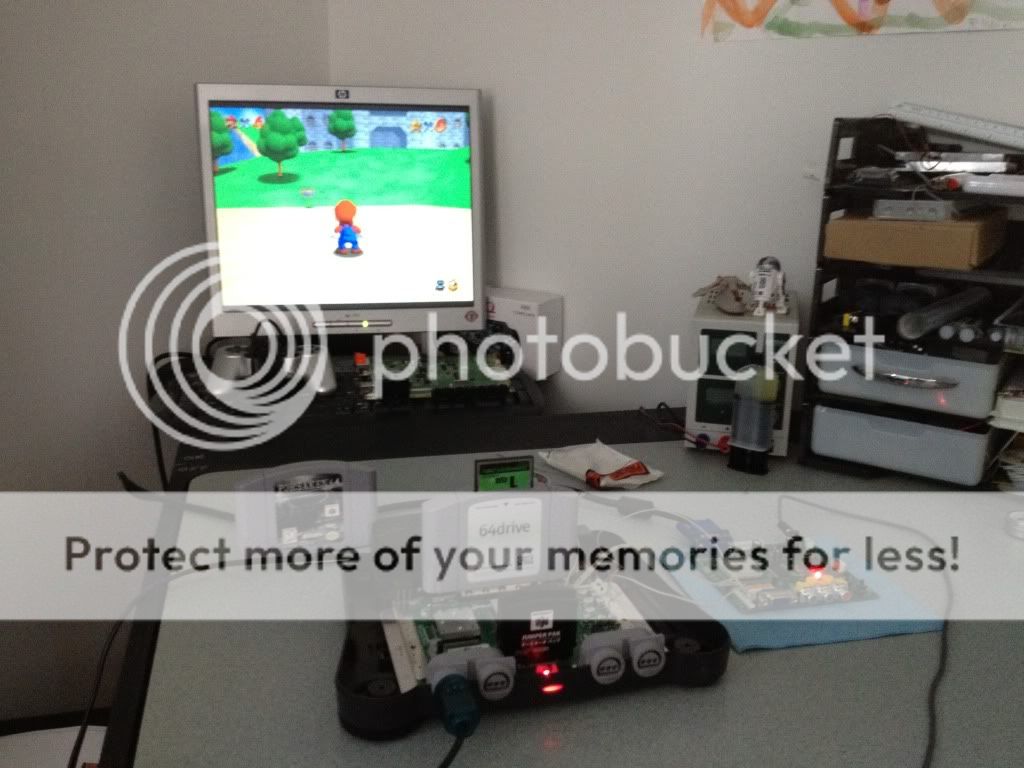

Well, might be a moot point for you now but actually yes I do have one of these adapter boards. I bought one a while back to play around with. They work pretty well for what they are, though they don't actually do anything to improve image quality. Just convert it to VGA. Here's mine running Mario 64 on a RGB modded N64:
I haven't tested all the other input methods, only RGBs. On RGBs it seems to not like higher resolution input. I have to blind select games from the 64 Drive menu because the 64 Drive boots to a 640x480 resolution. It might just not like whatever its getting though. I'll have to do further testing in the future when I'm not so busy.
